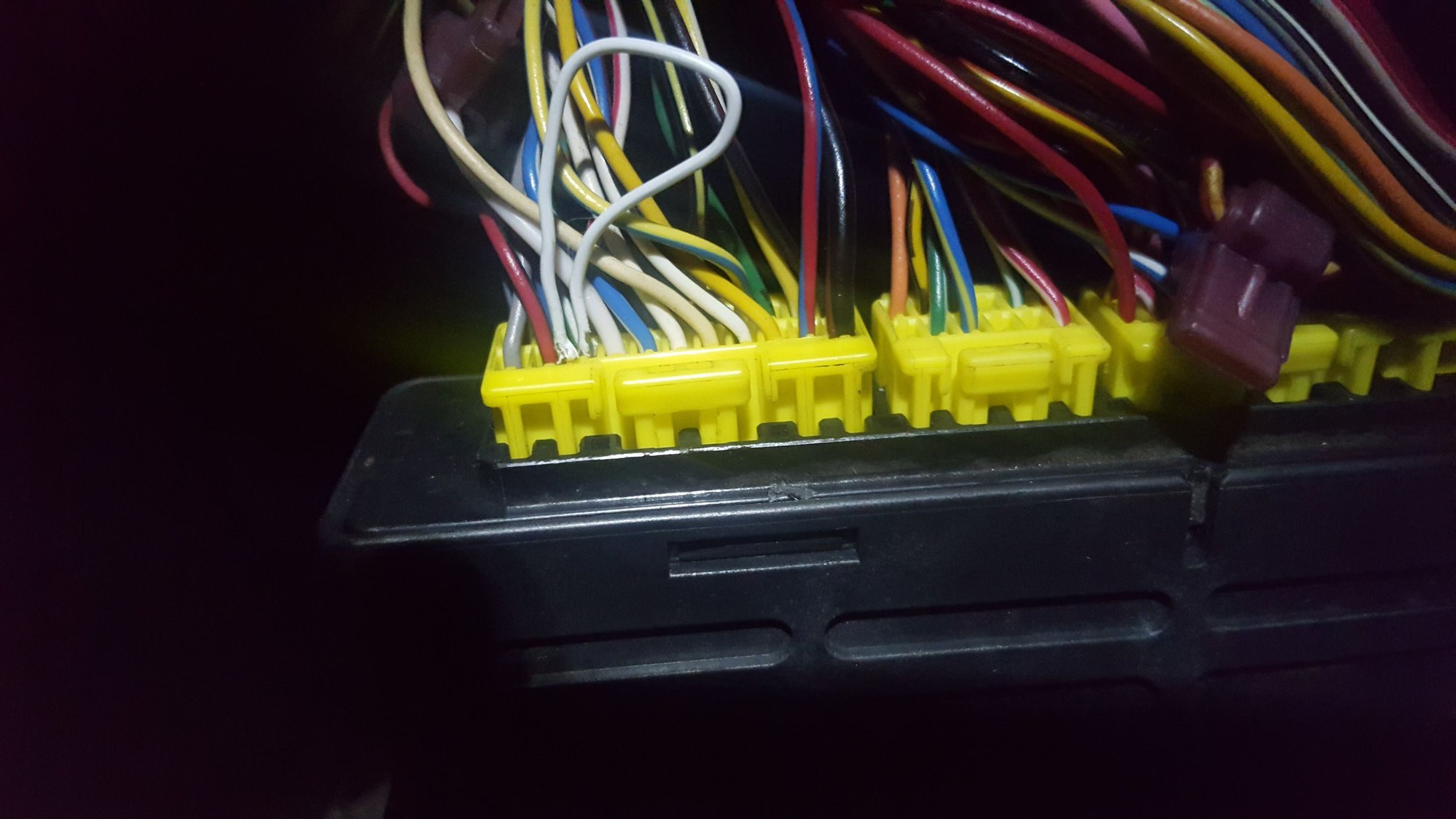

Old Aug 6, 2017 | 07:57 PM
ZMX's Avatar
ZMX
Joined: May 2010
Posts: 19
From: Indiana
When I put 12v to pin 79, the VAG COM FTDI cable wouldn't connect, and the car wouldn't start.
I am able to use the cable to datalog.
After looking at the pinout and seeing that pin 80 provides 12v power, I ran a jumper between pin 79 and pin 80. Did I do something wrong?
