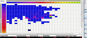

I have very little knock (see attached picture)

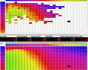

My timing seems to follow my map pretty well on average. It does seem to through in a + OR - 3 or so timing every so often. I attached a picture of average timings values for you to digest.
