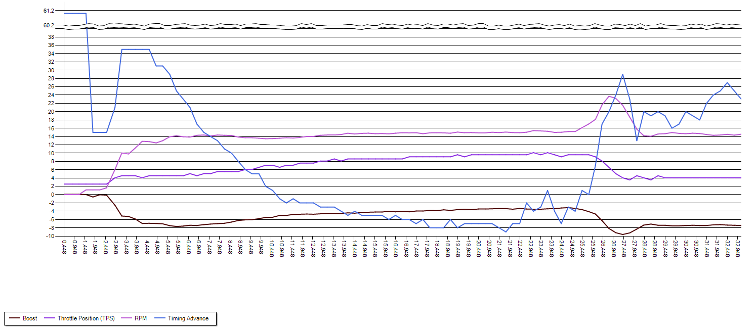

Seems to be working, only odd side effect is it seems to jump in RPM about a minute after starting from cold. Doesn't bother me. It just acts like I've blipped the throttle up to about 3k and comes back down. I think its where it all the sudden gets a ton of timing.
Edit: caught it on a log last night. See pic.
Ive tried this patch too and experienced the same thing as honki24
