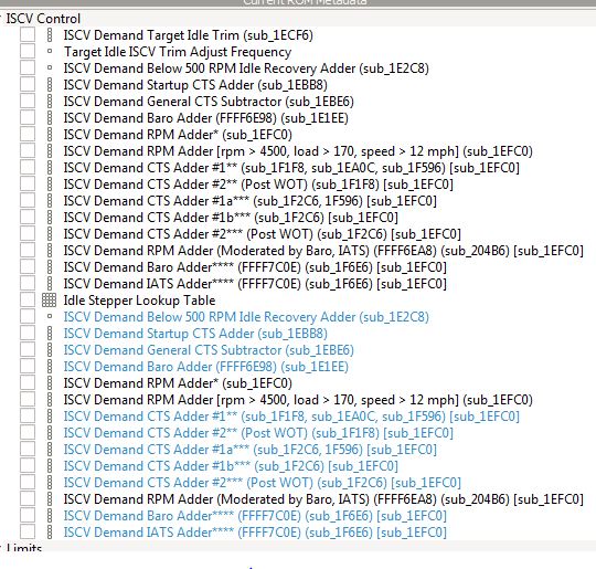

Which one of these ISCV tables can help me increase the idle and stabilize the AFR swing ? or do i need to add some other ISCV tables which actually control idle and start up fueling ?

Old Oct 24, 2015 | 01:22 PM
  #73
mrfred's Avatar
iTrader: (50)
Posts: 9,675
Likes: 132
Originally Posted by mines5
ok ill delete these 2 definitions and stick with your linearization table.
There are a couple of things i noticed which i would like to ask.
During cruising at steady throttle the car jitters doesnt drive clean. As soon as the throttle is pressed jittering goes away and car drives clean. pulls clean all the way upto redline.
idle is set at 1100 its idling at 1000 and with a.c on it dips to 800. All this is related to injector scaling and latency ? or i am doing some thing right ?
which tabless can help me improve idle and cruise ? 9653 maf version
its becoming very frustrating now.
You're asking questions that can't be answered without seeing logs and observing how changes to the tune affect the behavior of the car. You need to keep reading, learning, and experimenting with changes, or find someone who can tune your car. For the latter, just be aware that there are tons of people who claim to be tuners but are nearly as clueless as the next person.
