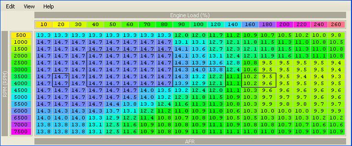

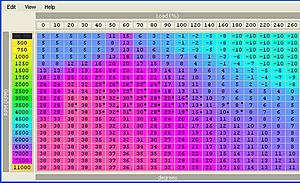

Hey guys, first off I'm running 94170015 and I just switched all my maps over to V5.10. I did a few logs yesterday and I have what I would call a serious knock issue. I'm getting between 3-8 counts between 2000-4000rpm/40-80 load cells as well as 3000-4000/90-180. I know I need to pull 1*/ 3 counts of knock, so here's my question.. Does my ignition map look a little "funny" to any of you? I'm seeing anywhere from a 4*-7* change between adjacent cells. Is the lack of smoothness a contributing factor to my knock problem? I've attached copies of both my High Octane Ignition and Fuel maps for reference. Thank you!
