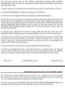

Here is a little something for you. Im sure you have this. Figure it was worth posting.

That's what I was looking at. That and a thread someone made on an Evo X forum. My problem is that I have no idea what my VE should be so at certain loads my trims would be good and they would be bad at other loads. I don't think I can properly scale the injectors if my VE table is messed up. Never would have thought about how that would affect scaling injectors.
If everything looks good at idle you prolly just need to change a few of the cells. Dont block tune. Block tuning on a SD map will only give you problems. Make sure it all blends together. Seems like youre almost there.
