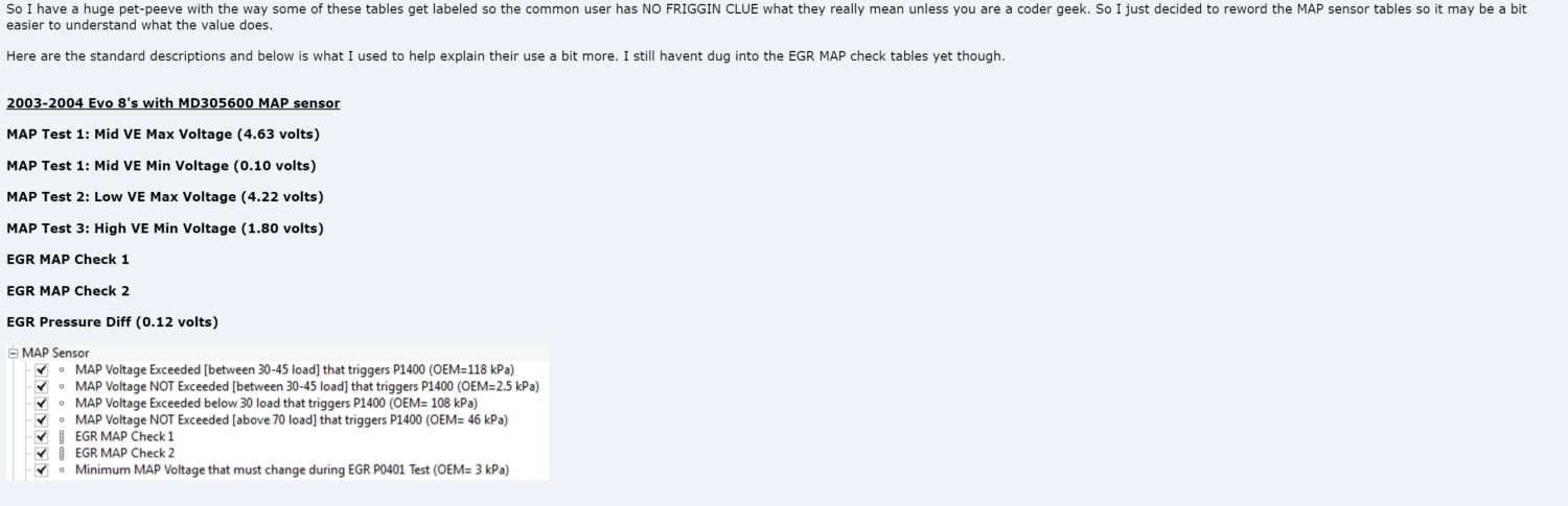

I really have look all over the place, so i am trying something else.
I can get to see this information on my ROM.I am using the 9653xxxx patch with mods v7.
can someone please post this information so i can add this to the definition file so i can change this setting.
the reason i am using a different map sensor that the ROM uses and I need to re calibrate this settings.
I will gladly appreciate the help

i cant get the option "MAP sensor" on the ecu flash, just in case its in developer mode all ready

XML for 96530706 attached. This include the MAP EGR test code and scalings.

thank you very much !I appreciate it
