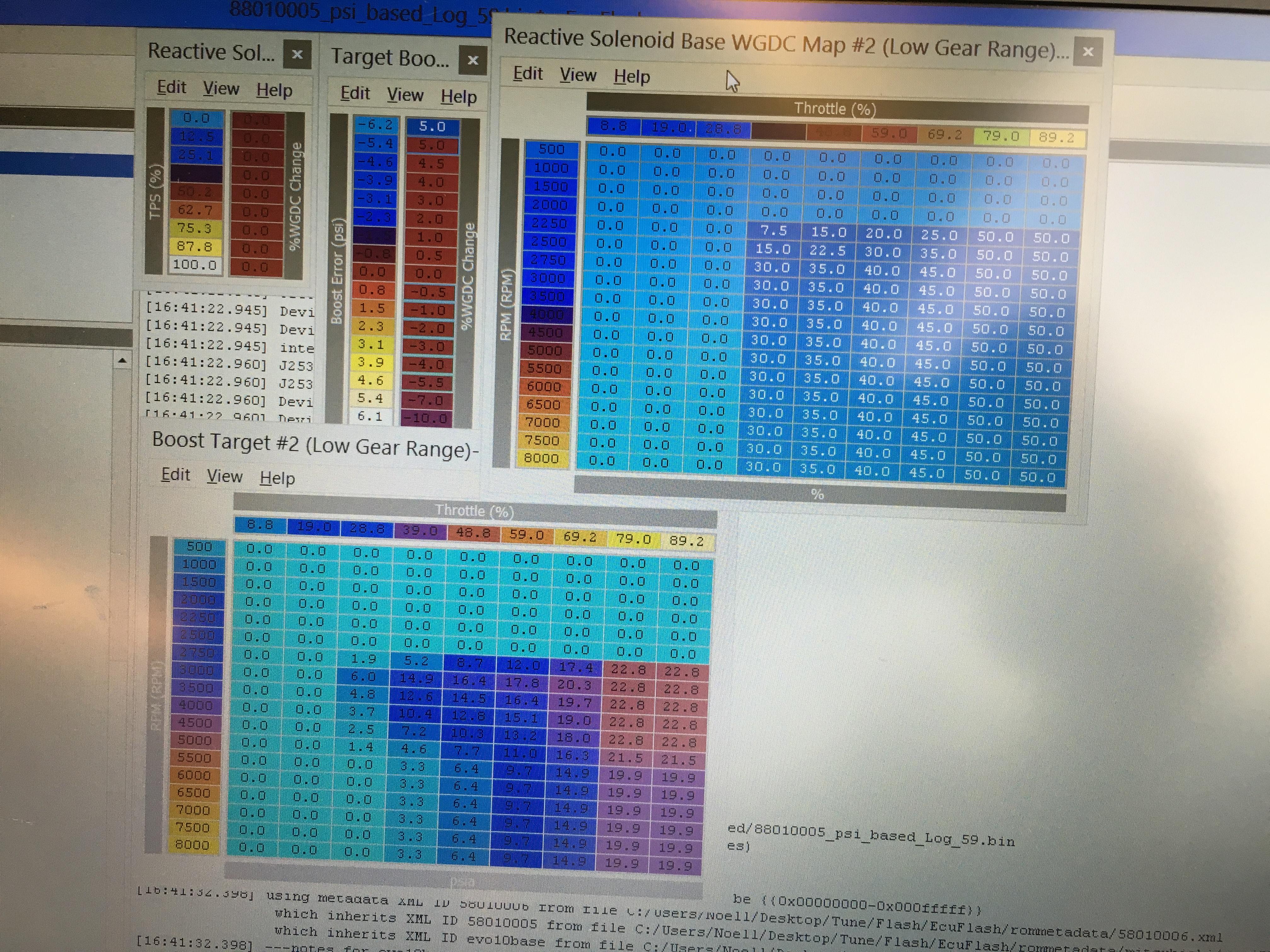

This shows 1 thru 4. Sorry it's a pic from my phone, no internet on the train.
WGDC are set back down to 50%.
Does this look right?
As for my XML, I'm using the 58010005 ROM from Golden's site.
In my opinion, you should:
1) Restore your Boost Error Correction values back to stock
2) Set all your Max Total Upward WGDC Correction vs TPS values to zero
3) Set your "boost target" tables a bit above your desired final curve
4) Reduce your base WGDC values
After that, SLOWLY increase your WGDC tables to achieve your desired boost curve.

Looks much better after implementing changes 1-4 psfp suggested.
Log0059 (green) was the overboost I was having yesterday.
Log0063 (red) was after the changes 1-4 psfp suggested, plus I pulled timing in the areas I had knock.
Log0064 (blue) is tweaking the WGDC for a better boost curve.
Still more to do.
I appreciate everyone's help.
