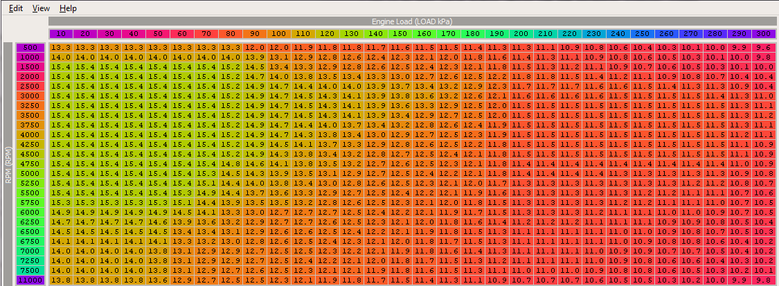

Recently I have updated my rom from 96260009(v5.1) to 96530706(v7) by following the info on the 'HOW-To 96260009 JDM8MR to 96530706' Thread. Everything seems good except the fuel map only go up to around 160 Load column for any load over 160. I am really stuck here, anyone got any ideas where should i look at?

https://www.evolutionm.net/forums/ec...g-9417-v7.html
I would try changing your load factor on 1byte in ECUflash and Evoscan from 1.2 to 1.4 or higher.

I have tried with changing the load factor to 1.4 with no luck. The timing map seems fine, but the fuel map still can't get past the 160 column.

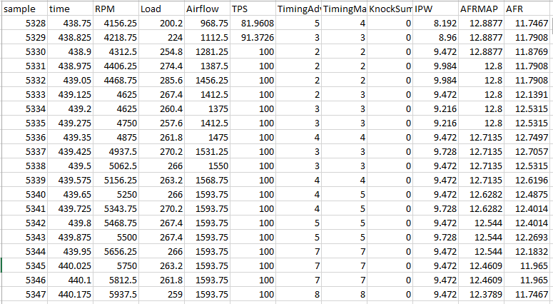

Which load are you logging?

I am logging the 1byte load, it hits about 270, which is quite normal to my car.
