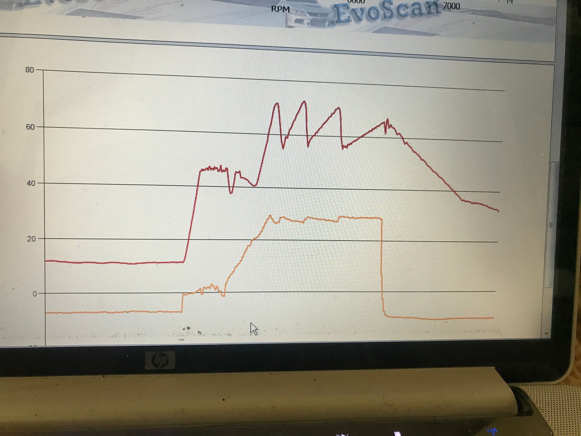

Hi I have :
evo x 2010 usdm
-turbo TPC GT SPEC
-Cam kelford 214b
-Id1050x
-SSP600 clutch pack
I install the patch and put the 3psi on the launch at 4600rpm
My car make some boost but the doesn’t launch fast before with my FP red turbo stock cam I was doing 1.8 60ft, now even with the patch i am at 2.2-_- , maybe my mivec is no good??? The fuel is good, I have no knock , do I have to set the stationary rev limiter now i am at 5500
Do i have to play with Max speed for stationary rev limit and stationary rev limit cross under max speed enable delay?
Is it normal I have « no match » in subruotine
is it normal my rpm go down up down and finally up on the launch
Look my boost(orange) when I launch i lose it going in vacuum
Need help thank!!!

yes the rpm bounce is normal, the 60' is slower because your turbo is taking awhile to spool. You really need V3 with its launch maps to launch any harder on that setup

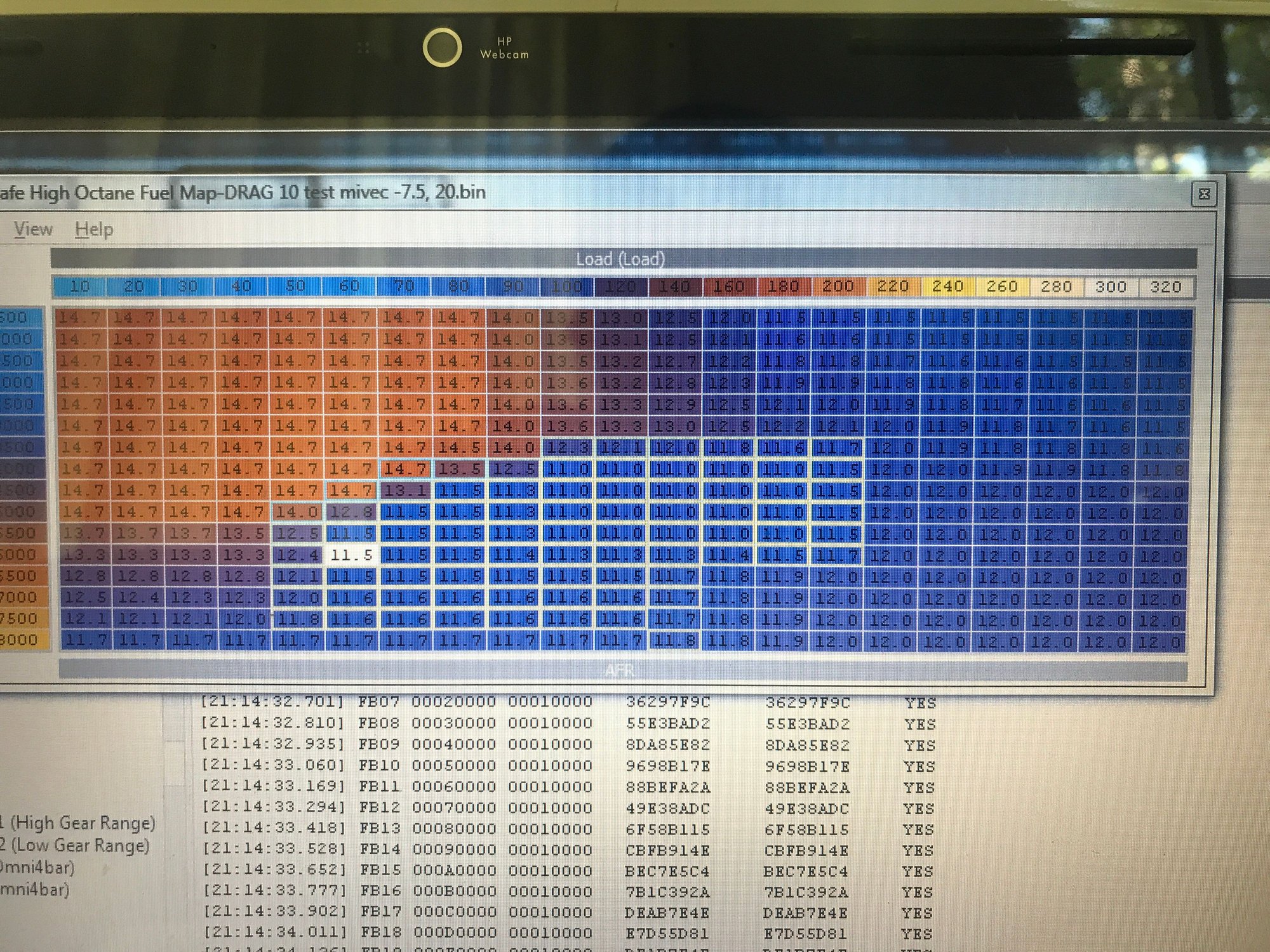

What do you ajust exacly in the launch map, the rev limiter because the fuel i will copy what i did for the fuel, i see the nlts but that is only for gsr ?
For a safe setup what boost on the launch do you suggest to have a 1.8 on the 60ft and Leave at the same rpm 4600rpm?
this is my fuel map
