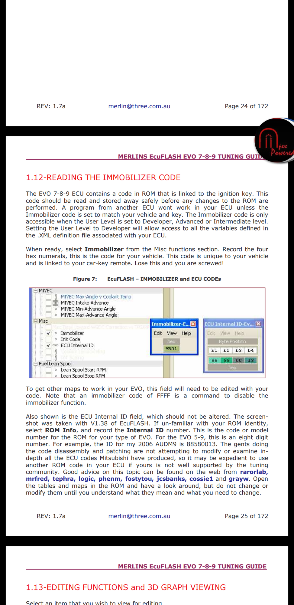

I have a evo 8 I just pulled my rom off the ecu. After it pulled it a box popped up, been following a how to and it doesn't state what to do. I'm lost been trying to find answers. Below is what pops up and what I'm trying to find.

That means you dont have the proper definitions saved in ecuflash.
Need to download. Copy and paste local disk c programs x86 open ecu ecu flash rommedata roms evo

You need the right xml definition file loaded in C:\Program Files (x86)\OpenECU\EcuFlash\rommetadata\mitsubishi\evo, before you can open the ROM. You may have a weird ECU ID. Save the file then open it with a hex editor. Look at 00000F52 - 00000F55 to get the ID. It should be something like 96940011 or 96530706.

Ok It has a tephramod v7. Got it opened at stuff.... now I need a stock tune for my car. Someone demodded this car and left the tune on the car. Runs like ****. I just tried a stock tune i found and car doesn't start. It had a green key flashing

Internal id is 94170715

You can disable the immob. Ecu periphery bit. Immobilizer set to 0

Like just 0? Right now the one that starts the car says 0000

Make sure you copy over the immobilizer code from the 94170715 ROM to your stocker. That is why the green key is flashing

I have

Alright it starts. Disabled the mobi. Still has the issue running crappy. Guess I'll post in the other page. A bit lost. No codes
