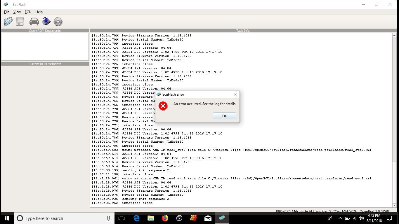

So I'm trying to read the map on my 2015 GSR for the first time. Downloaded newest version. Have my openport 2.0 cable. But, then this happens..

What strikes it odd for me the most is the /read_evo5.xml. Does anyone have the 2015 XML definitions? Golden's site seems to be down.

You are using the wrong setting, make sure you use Mitsubishi CAN in ECU type.
You can grab the XML from my site here: http://norcalmotorsports.org/users/b.../ROMs/XML/Evo/

Ecuflash now has settings? Shouldn't it know what ECU I have if the correct XML is there?

You've always had to select which ECU to connect to. Evo 8, Evo 9, Evo CAN, Subaru, Subaru CAN, etc.

Thanks, Bryan. I loaded up your XML and was able to open a 2015 bin file I found online. I'm not near the car now, but will give it a go tomorrow. Thanks for the reminder on choosing which ECU. For some reason, the window didn't pop up when hit "read" and my long lost memory didn't kick in. lol

Ecuflash is working great. Thanks again, Bryan.
