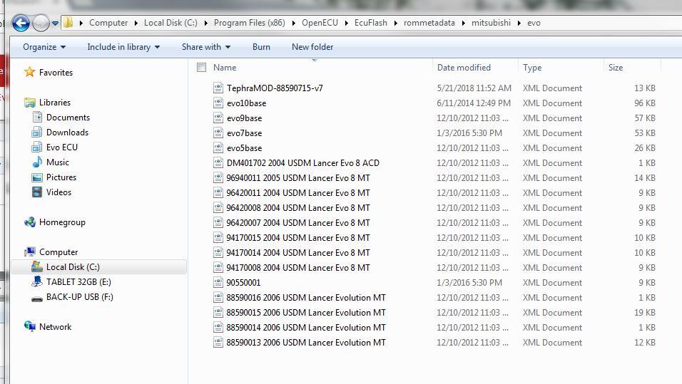

I am also getting this UNKNOWN ROM error when trying to open 2 different HEX. rom files i read from two evo 8 ECU's, used a 1.3 cable and evoscan to download them.
I have the tephra v7 XLM file in Rommetadata>Mitsubishi>Evo and all the other XLM files that came installed
So i think need help finding the right definitions for these 2 files.
The first ecu was in a 2003 Evo 8 USDM and the second was bought used and tested using this evo.
Also I have a evo 9 with a tephra map and i can read it so i don't think these are tephra maps.
.Thanks in advance.
P.S.
A pic of just the USDM definitions im using.

Add the Tephra Evo 8 ROM to your list and you should be good.

I know it's not in the screen shot but I do have the evo 8 tephra map in there and I still can't read these 2 maps. If anyone can read theses maps let me know.

Evo8_2_FlashImage_20182005_2259.hex has a ROM ID of 96531706. You will need to add the 2D SD 96531706.xml to your Ecuflash metadata directory to open it.
Evo8_FlashImage_20182005_2256.hex has a ROM ID of 94151715. You will need to add the 2D SD 941715.xml to your metadata to open it.

Hey thanks,
I Searched and I find a tephra definitions update pack I download it put the XLM files and everything opened just fine.
