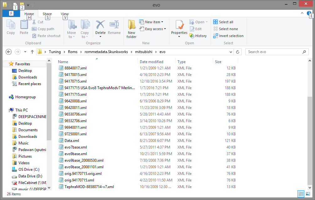

Hi, in your ECUFLASH Rom Metadata folder do you have multiple copies of the rom file? If so, rename the original versions to something else, and make sure the downloaded one is the only one named correctly, if that makes sense. Also, from the two tables you are showing, they look pretty stock, compared to other EVO 8 Stock rom data.

See above pic: NOtice how I have the 94170715.xml named correctly, but lower in the pic you see Orig.94170715.orig.xml... THis is so I ecuflash wont use the one named "orig" before and after the rom #.
