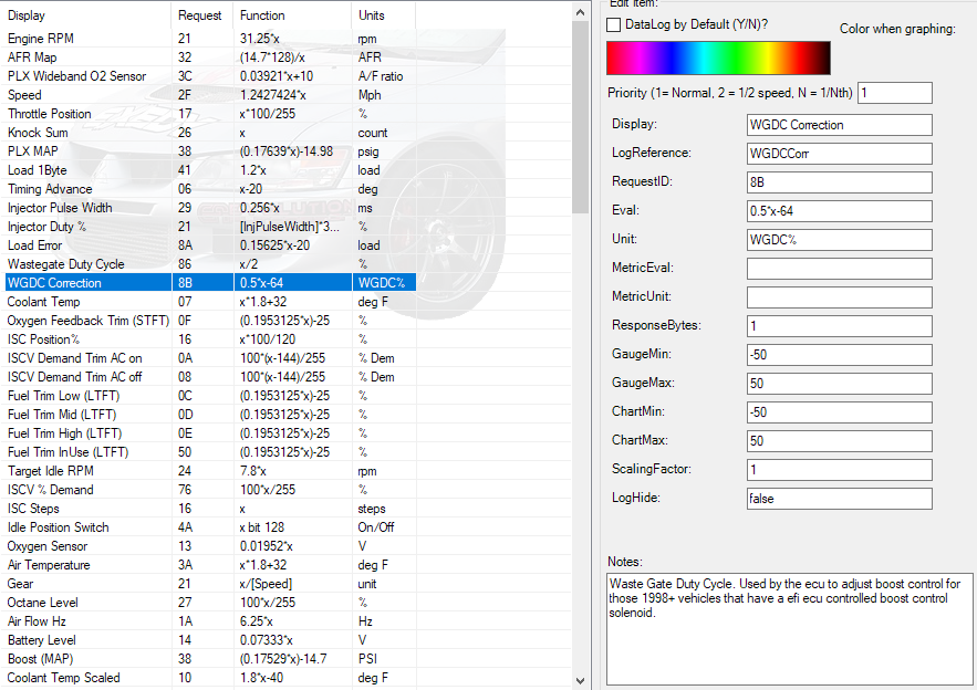

Hi guys,
So I'm fiddling with the boost tuning on my Evo 7 ECU (90550701), and logging WGDCC gives me 63.5 all the time. The evoscan settings are below, maybe I have the wrong RequestID? I did a bit of searching, things like "WGDC
correction 63.5" and found some people with similar problems but no definite answer.
Ideas?

Hey mate, did you ever get this figured out? I have the exact same issue and cannot find any answers......

Nope. Still to this day.. Doubt it will ever get fixed.

It sounds like you are reading the wrong RAM location for WGDC Correction.
Check your MUT table to make sure you have 8BE3 in the MUT8B cell.
