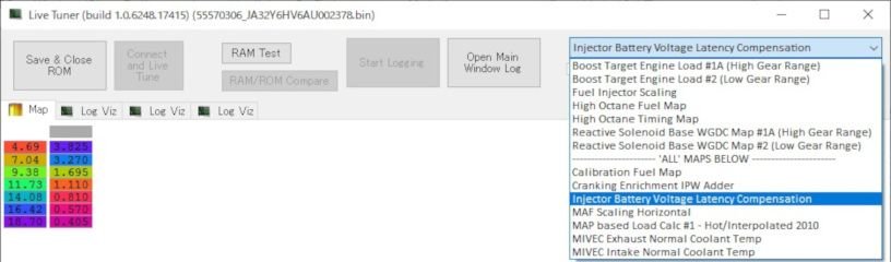

I pasted your TephraMOD-55570306.xml and 55570005.xml to my ecuflash/rommetadata/mitsubishi/evo/ folder.
Result is like below pic. LiveTuner works well to your rom with the corrections I have posted. Issues of the definitions for your rom were corrected properly.
As far as seeing the result, I have to say that there seems to be some kind of problems somewhere in the installation state of your ecuflash and LiveTuner. it seems to me that your ecuflash is still reading some old definitions from somewhere.
