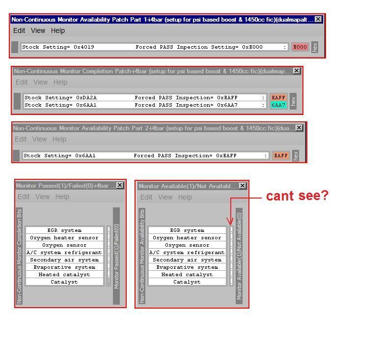

I'm trying to apply this Force OBD Inspection Pass patch and I'm running into some issues:
https://www.evolutionm.net/forums/ec...us-mrfred.html
I can't see the values in these "Monitor Available/Not Available" & "Monitor Passed/Failed" blobbits tables? I'm hoping that this is a relatively simple question for someone.
Thanks in advance for your help.

I ran into this a long time ago and never got an answer as to how to fix it totally but the cause is typically windows scaling not working correctly with ECUflash. If you set it back to 100% you should see it just fine. Of course it might be tiny if you have a high res laptop you're using. In general, I try to stick to 1080 or 1440 laptop resolutions in general because the windows scaling issues are pervasive along a lot of different programs.

Thanks, but what do you mean by set it back to 100%?

incorrect scaling for the table

Thanks, can you point me in the right direction on how I fix this?

Got it fixed by using a different xml file.
