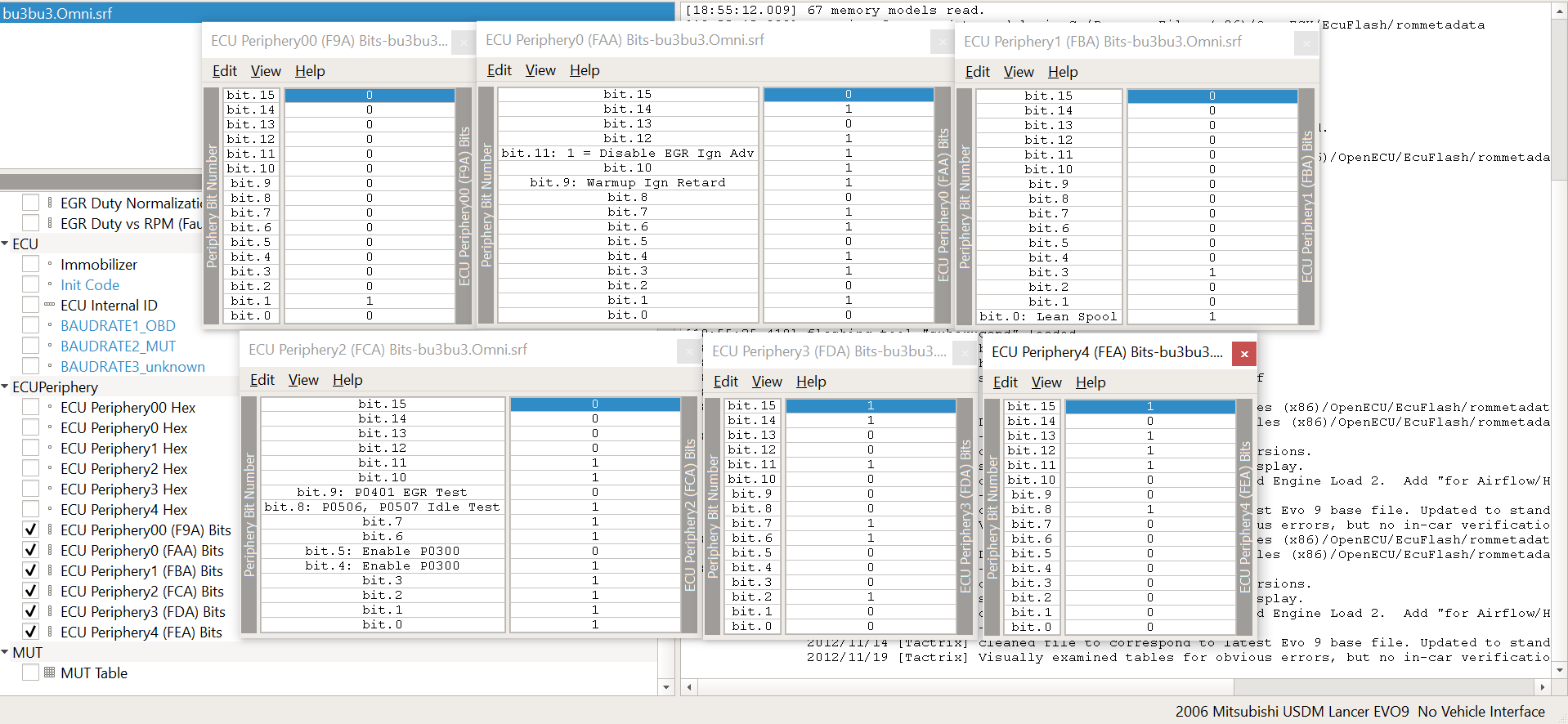

The soon I switched the plug " Spoolinup Speed density cable" to the GM IAT from the stock MAF, the car was running but with CEL light on, the Two codes that i pulled were P0102, and P2228. Here is the " ECU Periphery"
My goal is to get the car running without CEL light, and take it to a shop to get it tuned, This ECUFlash operation is way too much for me, but I am stuck in the middle and I need to get it taken care of and move on to a shop knows what they are doing.
