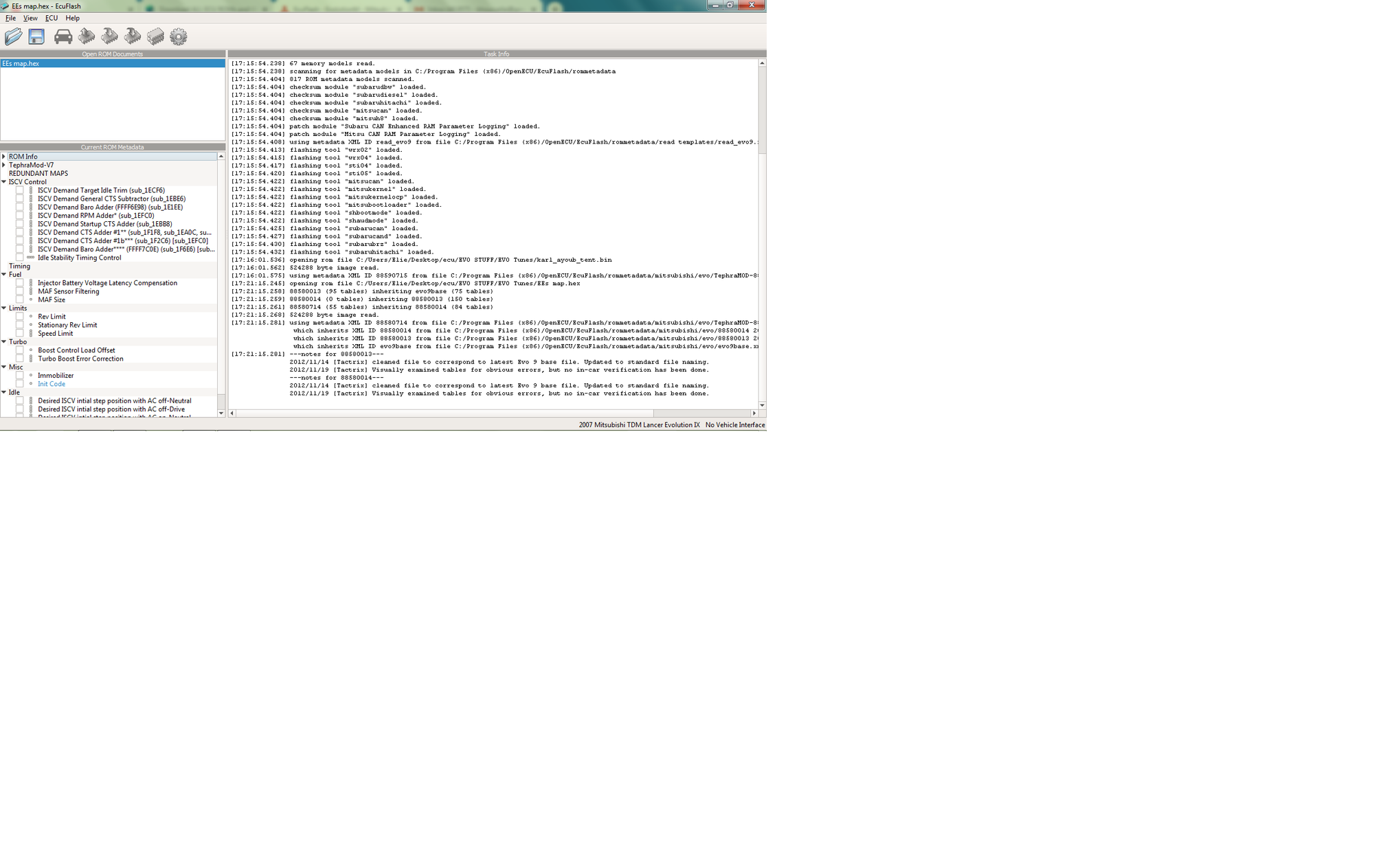

Hi All,
I quit tuning for few years. Just now I decided to start again. I downloaded the latest version of ecuflash. I'm having a problem with all roms for edm evo's, that I can see a very limited number parameters. Below you can see what are the parameters i could see + tephra mods (no mivec, no periphery, no injector scaling, etc...). When i don't use tephra v7, i see the same parameters minus the tephra mods. Help much appreciated. I tried downloading xml's again and again. The xmls seem to have all tables defined, just they don't show in eculfash
Help pls

Good to see fellow Europeans here as well, according your problem. Open EcuFlash --> file --> options --> user level = set to Developer if not done already that should show you more tables.
