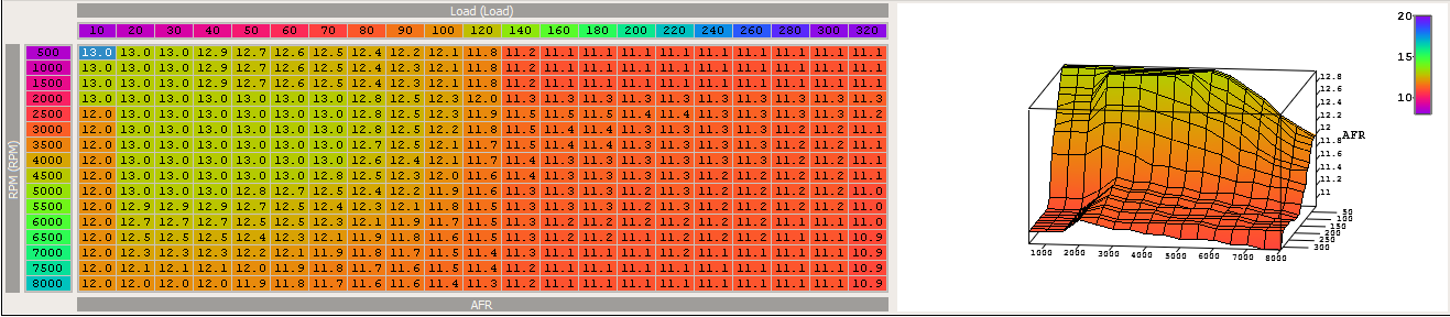

I have tuned my AFR according to the below :
Spool 12.2
High boost high torque 11.4 - 11.3
High rev 11.1

Just a quick Q, why is everything at low loads and RPM at 13:1?
I get black smoke on boost, which is completely normal. Not all fuel is being burnt at AFR richer than 14.68, and any unburnt fuel will cause particulates. At ratios under 12 you will get PLENTY.
If I were you, I would change all the 13.0's to 14.7. Then blend the cells so it;s s smooth transition to your boost areas.
The less fuel you inject, the less of it gets in the oil, and washes down the cylinders.
Back to your smoking issue, I don't think it's a problem as long as your actual, measured AFRs at the exhaust are in safe ranges, and your fueling system is consistent across all cylinders.

1- When I reduced my latency (for testing) I have lost the correct richness at idle, therefore I have set the 14.7 cells to 13 and modified the low pulse adder table in order to preserve my idle and low rev drivability.
