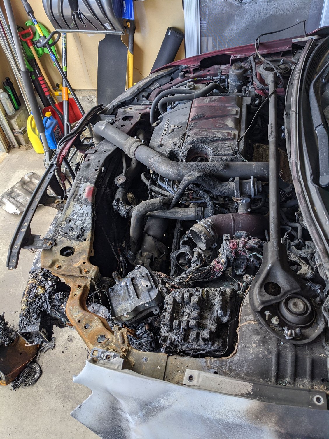

That where my dilemma starts, the ECU was toasted in a fire. I will be trying to revive it via bench, but it may not happen. I replaced all wiring and got a replacement ECU, when I plugged it in I got and ETAC error (used ECU had different vin) so I recoded the ECU vin to match my vin. The error went away, programmed the key but I get a no start. I am assuming the used ecu may have a modded rom or different one other then my vehicle, the radiator fans dont come in until Wednesday so I dont know if the fans go full speed indicating an ECU issue. If you have any other suggestions please let me know. Picture shows what I am working with.

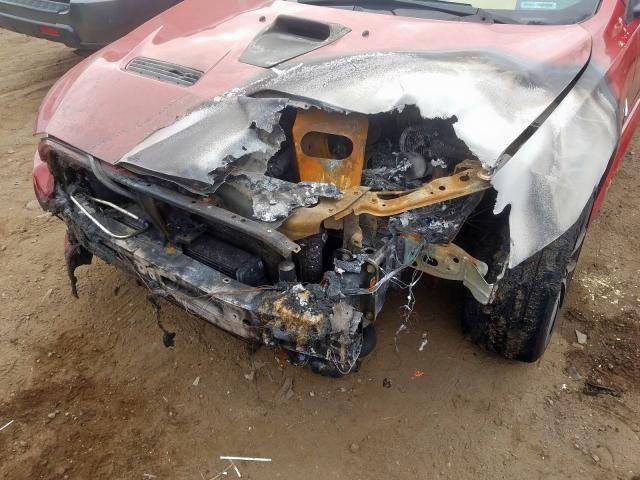

No battery is in the trunk, I think the generic demon eyes that were installed was the culprit. As the source of the fire appears to be at the driver headlight(which was completely gone. I was able to recover the ECU (at least I think it is) to atleast get a rom. But EVOSCAN saving doesnt know the definition. Is there somewhere I can get details for that?
Keep in mind I got the car like this, I so I dont know for sure what happen. Just guessing with the fire pattern.

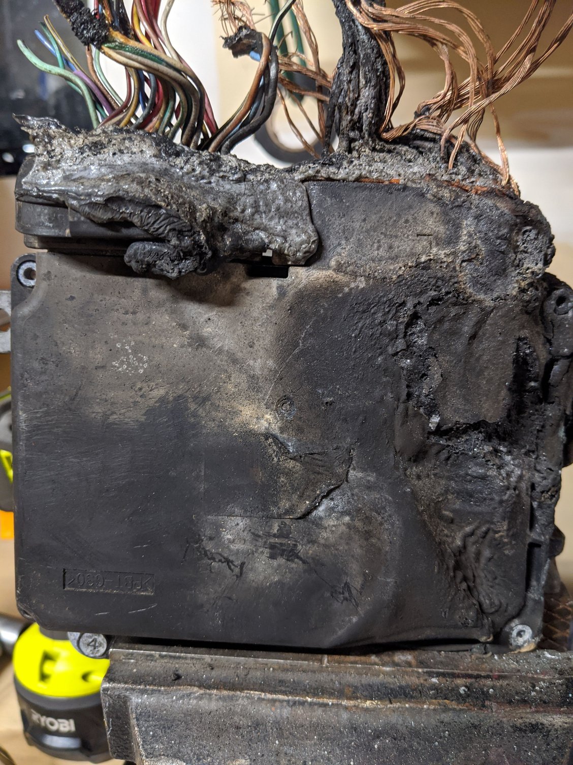

I was able to get a rom from the toasty(burnt one) ecu, it appears the identifier is 59580006. which correlates with a 2015 gsr. I found the definition file and going to try and read the rom again. Still suffering from a no crank no start, but the relay is clicking. I will be diagnosing the starter alternator assembly wire soon.

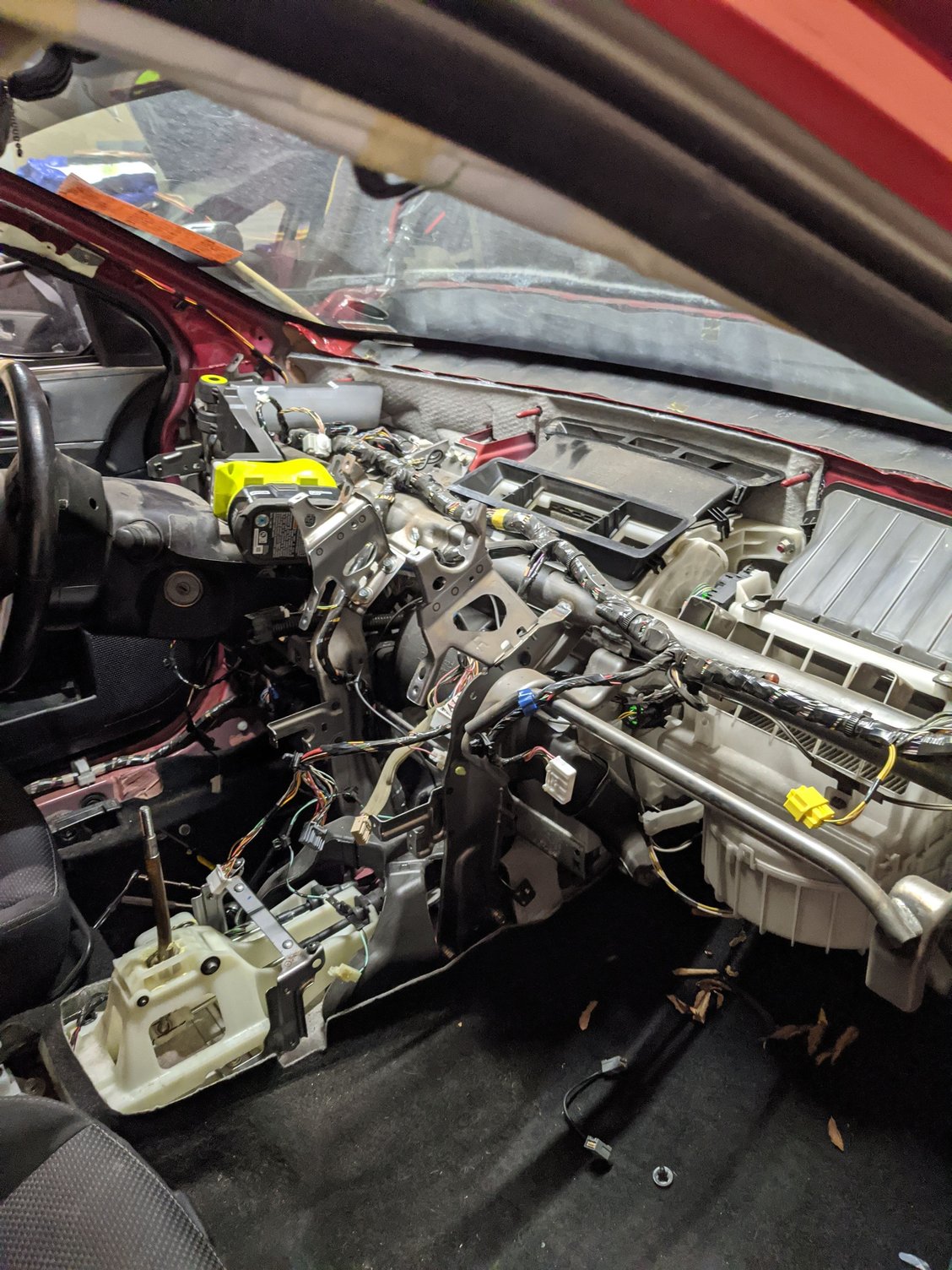

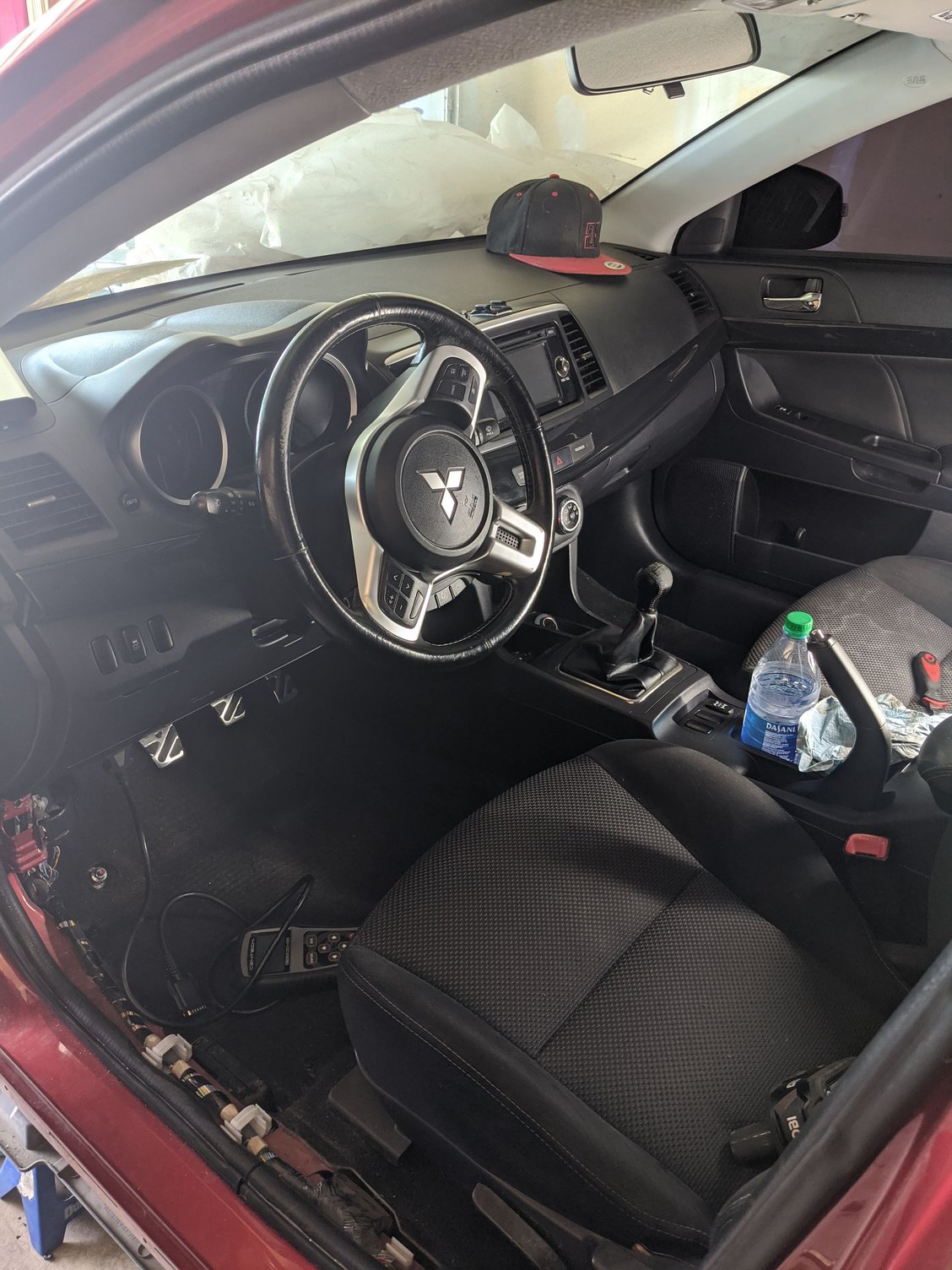

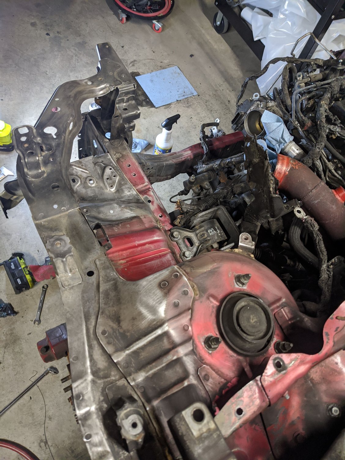

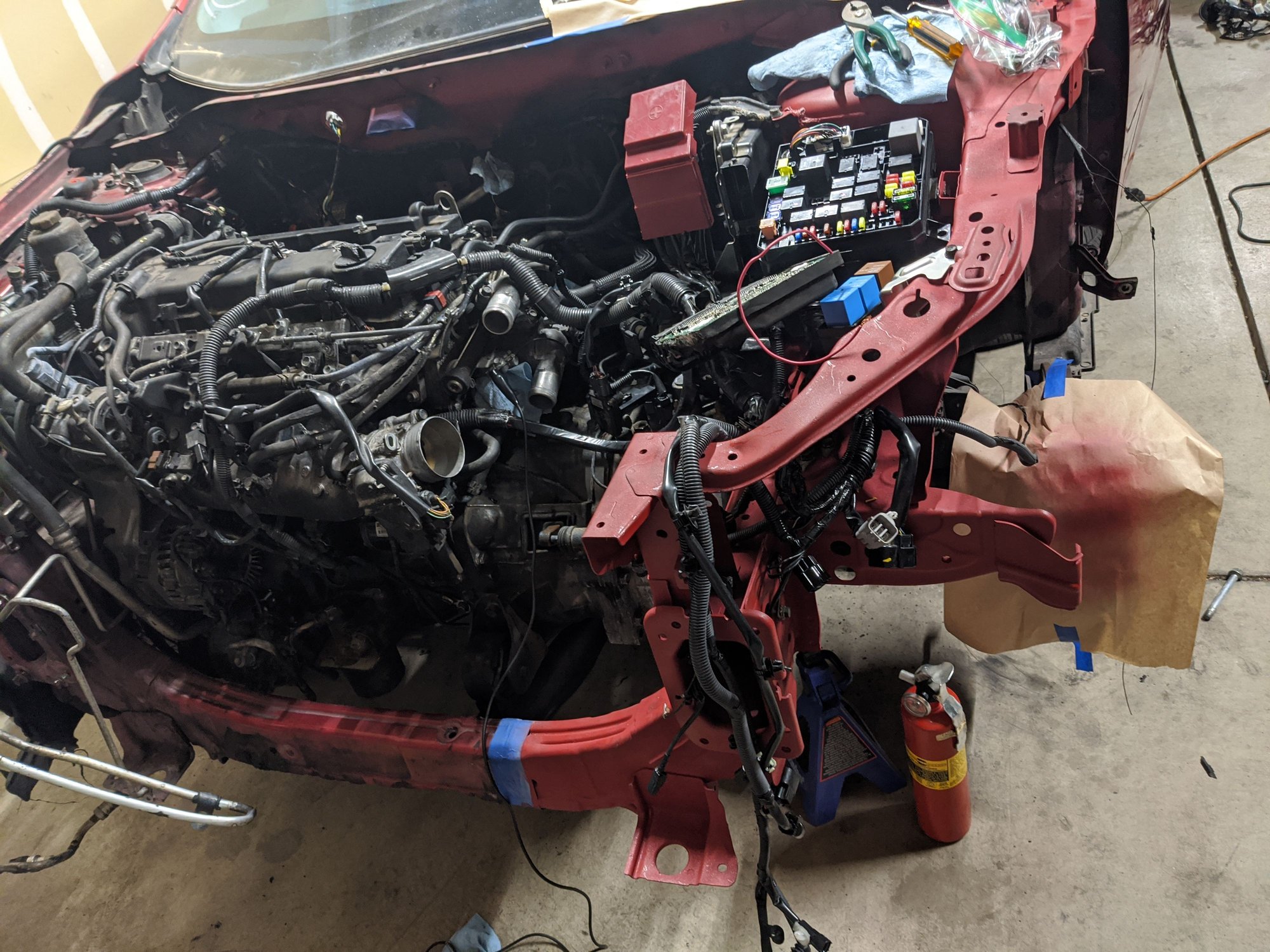

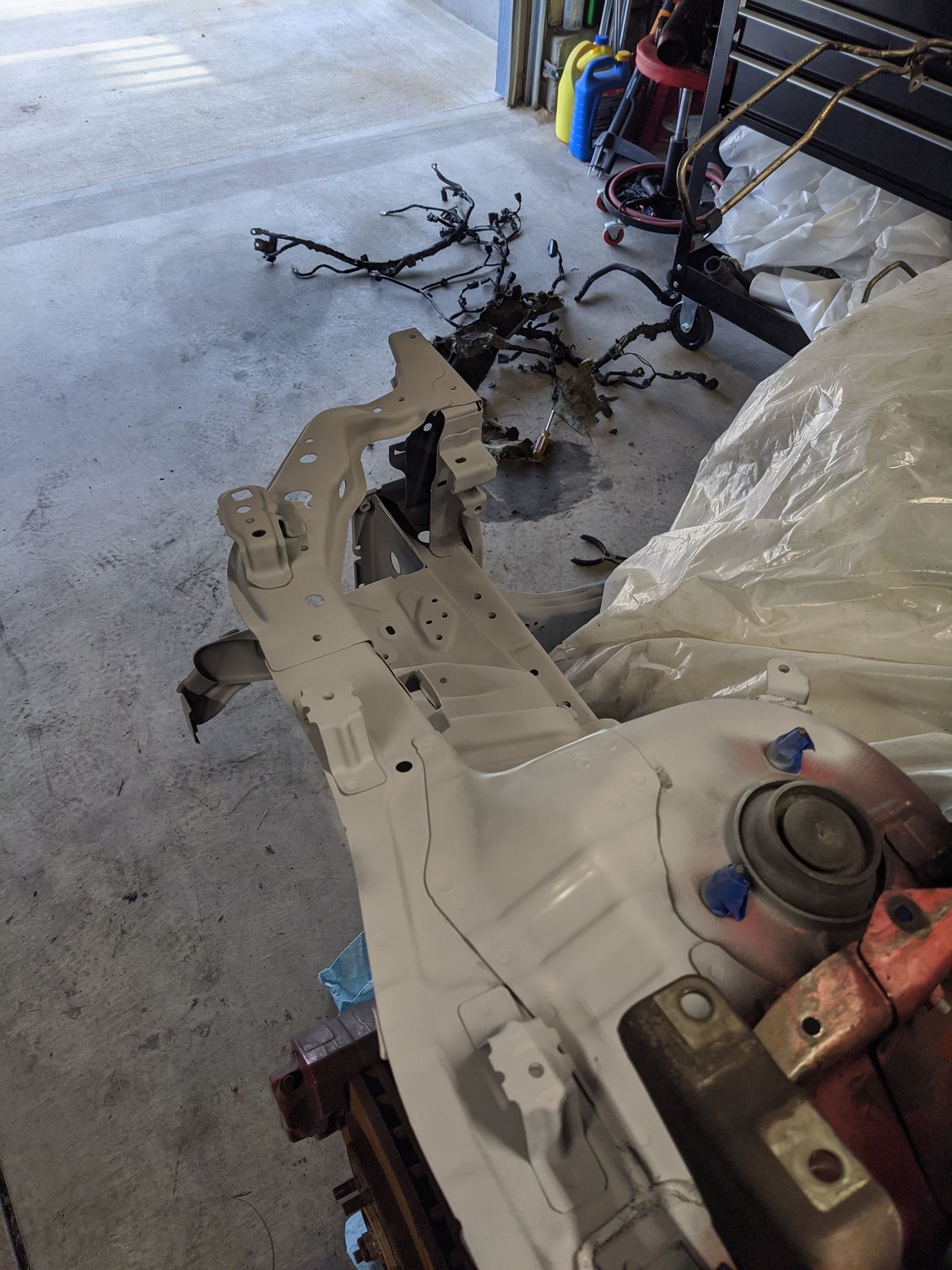

Its not all that bad most of the heavy work it done. See the pictures for the progress, plus I got this quite cheap. I was thinking of swapping shells, but in the US everyone wants gold for these Evo's. The two harnsess that were toasted was the chassis harness and the engine harness but have already been replaced and quite cheap too. This may be the cheapest evo in the US right now. Only thing I got left is trying to find out why she doesnt crank, maybe immobilizer but I already programmed the key and the starter relay clicks on.
before beginning work
toasty ecu
sanded rusted primered and rigidity check
grey primer
replacing chassis harness
interior complete
removed burnt pieced from old ecu to get a read
front end whole shot
another picture of chassis harness and old ecu.
