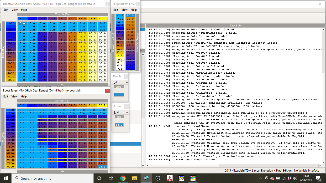

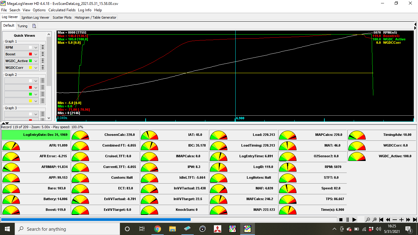

Its probably because I'm not understanding something correctly and have something off in one of my boost tables but I can't build anymore boost then spring pressure. I running a 59580304 rom with a Garett GTX3071r gen2 turbo with full exhaust, Omni 4 bar, MAC 3 port ebcs and supporting mods. My (Omni 4 Bar Boost) Boost Target #1A,B,2 is set to 25psi. The (Turbo) Reactive Solenoid Base WGDC Map #1A, B, 2 are set to 99 and (Turbo) Reactive Solenoid Error Correction Interval is 7. No matter what I change or how I change it the boost stays the same. I was using a Tactrix 3 port ebcs with 5/32 hose and changed to the MAC with 7/32 hose. Port 1 (right) goes to the intake tube, between the air filter and turbo. Port 2 (left) goes to the IWG and Port 3 (center). Log from the 3rd gear pull is attached.

It was 100% the plug. Dropped the tables down to 40 on the high end and end up at 53 with a 20# wg spring.
I set the correction internal to 1 as recommended. Does entering a value of 1 offer the fastest or the most amount of wastegate correction and what is the range?

1 sets it to the fastest interval of WGDC Correction. The actual percentage amount of correction is set in the Boost Error Correction table.
The standard 7 is too slow once you start making decent power.
