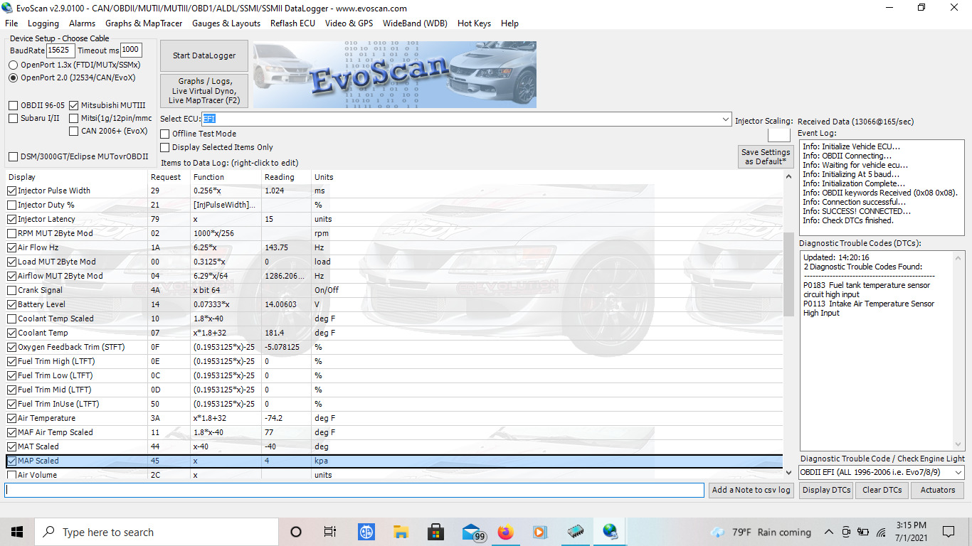

Well you are some what on the right track. Flashed test2 to car and checked evoscan and i didnt see maf air temp scaled was reading what seemed to be ambient temps.
Still have the cel on though. Think that is due to the tuner pegging the MAT temp to 90.
I attached the log and heres the screen shot of codes.

Have you tried clearing the codes? I have them disabled so I am not sure why they are still showing up.
Also, without an actual IAT sensor, I do not think you can have the Air Temperature reading. If someone knows better please correct me.
Although the car should drive fine, I think. Let me know.
If it drives fine, no CEL, and MAF Air temp is reading correctly, you will just need to wire an actual GM IAT sensor into your UICP before the TB and run the wire to the ecu.. I will check which pin exactly.

So cleared the codes and there was only one that remained. It was p0110 intake circuit malfunction.
Decided to try the FIC2150rev1 rom set to IAT as the input and i get the same code now p0110.
So I changed the input over to the fuel temp and no cel using the 96530706 rom. Car just runs like **** using it. Tried changing all the tables over to what the tuner inputed and I cant get it to run as smooth as he did still.

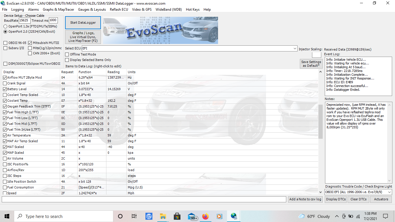

Well that definitely was the problem. Using a 9417 variant rom on 2d speed density with the GM IAT sensor as my input through the IAT pin 72.
Only thing i need to figure out is why i still get a -40 readings in evoscan for my MAT scaled.
pretty sure its probably my formula in evoscan. have to see if i can find the correct one unless anyone can point me in right direction..
