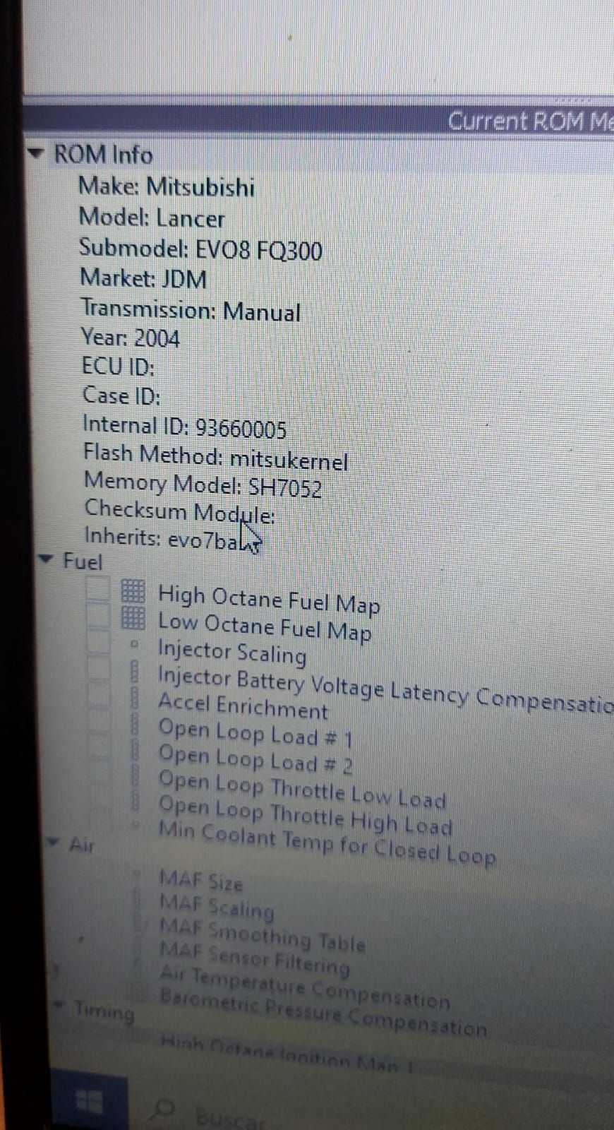

I just bought a evo 8 fq300 and a openport 2.0, been messing around in Ecuflash for 2 last days and reading a lot on forums.
And feels like I'm missing a lot of setting when editing the ROM. I tried to search the web and this forum for a better definition file but all of them are the same.
So the question is, are there any replacement rom I can run or a better XML file ? Is there a possibility to run Tephra mod ? If so what rom suits best for an fq300 ?
Right now I'm running stock rom for fq300, 93660005 3 plug ecu. Also I'm running 1.44.4870 of Ecuflash

My 8 GSR came with the same ROM and yeah, the definitions and mods for it are very limited. The closest Tephra Mod rom for it is 9626079. I run 96262709 (DMA version). I think the easiest way to get the ROM is via the Evoscan website.
Alternatively, you could go for 96530706 and generally follow the guidelines here: https://www.evolutionm.net/forums/ec...6530706-a.html
Ziad created that thread because 96260709 didn't exist at the time, but I'm sure it's still a good option.
I've attached my 93660005 xml as it's a little better than the standard one but I stopped adding to the definition years ago.
