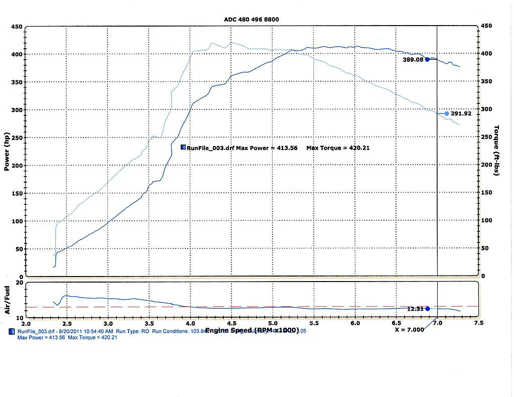

I had blown the head gasket back in january. finally got all the parts i needed to tear it down & get it back on the road. full head machined, valvejob. while that was off, i did some Kelford 272's, Crower springs/retainers, HKS cam gears, Gates timing/balancer belts, Power Enterprise acc. belt, new water pump, FIC 1250's, FIC rail, AMS return fuel line, FueLab FPR, speed density swap, used EVO9 turbo, & HKS R.S. filter tuned on E85 by Phuong over at Wingz Performance. Dynojet used was at AZ Dyno Chip.
car made 413.56whp/420.21tq in 103 degree AZ heat!! AFR's are in the 12.3 range.

Nice numbers. Stock block? And what kind of mileage do you get? City/Highway?

yes stock block. i never really measure fuel economy. i did use 30gallons of E85 in 2 days so far. when i used 110 leaded i averaged between 4-7mpg's but fuel economy is not why i bought it...
