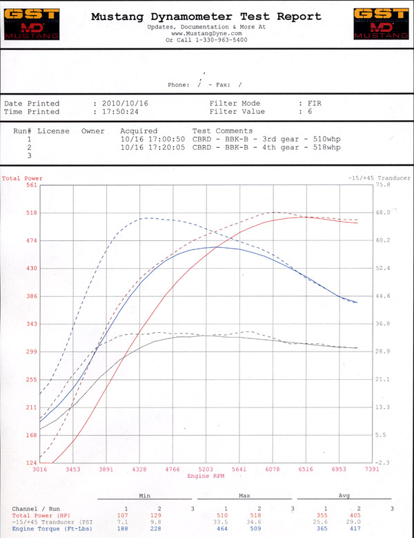

Looks great for that boost level Zhong.
For reference, you probably remember this one. 2.3L, BBK-B, set on street kill, bit more boost then you are running, 3rd and 4th gear
