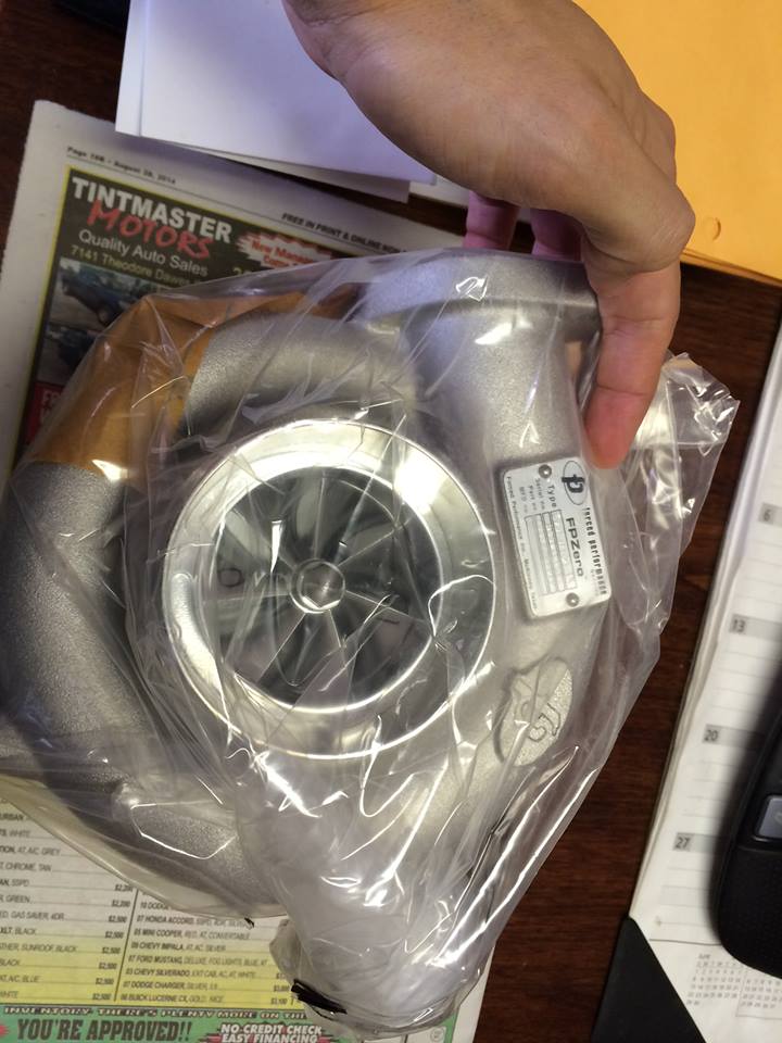

Me and Mo finally got to tune his car on the FP Zero. After first tuning a few nights ago and making nice numbers on 93oct (600whp+) with more in it, we decided to switch out to E85. First few pulls on E85 I knew something was a little off. The fuel pressure was dropping at higher RPM, while the injector duty cycle was still great and the afr was good, I didnt want to continue like this knowing what is happening.
I had him pull his pumps. He modded, and replaced both I believe. First pull on the new pumps 1.5 FULL points richer! Success! now we can see what this turbos really made of.
Heading up into the 85%+ injector duty cycle territory with a 12AFR+ I knew we were really pushing some serious air with this car. WGDC still under 90%, I didn't want to overspin the turbo or **** it off, so what we did instead is a 4th gear pull to see if it would naturally run more boost, which it did and IDC increased vs the 3rd gear pulls.
Just enough to touch slightly over 800WHP, which we were happy with. Later on I will post another result of the Zero vs the Black on this vehicle, but for now this thread will be released only.

A picture of the vehicle below, Along with the Turbo, that makes these results possible.
