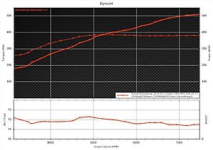

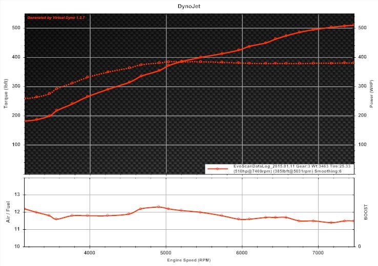

Smoothing 6
Evo IX / BBK Full / E60-uwktdks.jpg
Smoothing 3
Evo IX / BBK Full / E60-csiu3sn.jpg

It's a little lean between 4500-5500rpm. I plan to richen it up a bit more to get it in the 11.8:1 range.
Kept the torque below 400ft-lb to protect the rods
Highest IDC hit is 75%
Boost is 28psi tapering to 25psi
I'm hitting 4* at peak load and ramping up to 18* by 7500rpm
My car weighed at the track with a half tank is 3425lbs. I currently have my winter wheels/tires on and the logs were done with 3/4 tank.
On 91 octane pump gas + e10 tune the car did 380/318 mustang.
My car is a daily driver and reliability is key for me hence the flat torque below 400 ft-lb. This is my first tune on the car since switching to ethanol. I plan to go higher content in the future but I'm pretty happy with the tune for now. Future plans include an English Racing budget 2.0 (Wiseco HD 9.0:1 with R&R I beams etc), Kiggly Beehives, springs and Ti retainers, Kiggly HLA and GSC S2 cams and a 25psi Turbosmart wga.

looks good but is quite a bit inflated from 6200 and up

What makes you think the numbers are inflated from 6200 up? A smoothing of 3 vs 6 shows difference of 11hp or 2%

The shape of it, it dramatically increases from that point on. Your torque also begins to actually go up from 6000 instead of down or leveling out. My guess would be around 470-475 whp based on years of using the program.

Fair enough...I'll post my graph when I get it on the roller. Keep in mind I only have access to a Mustang. So if I do the conversion in VD it should be around 445/335. I myself found it surprising but I did a number of runs and I consistently got around 500whp. Likewise my VD and Mustang numbers have always been very close in reality. At the end of the day I just want to hit mid 11s reliably...a number is a number.
At the same measure, my car isn't speed density but bbk fulls have done 500/450 or thereabout.

Yea, they do 500 on E85, that a significant difference in fuel. Its definitely weird how your torque holds flat. You can see on the 2 cars you referenced that the torques tapers off, and yours doesn't. Good results either way, even if they do turn out to be high. I want a bbk full or B, but picked up a 71hta recently. Couldn't pass it up for the price.

Probably right at 440 +/- dynojet on this setup. It is very similar to my old setup and I was right at 420 but I didn't have the manifold you are using. Either way it should be able to get you 11.5-6 at the track.
Talk to mychailo about his old setup as he is the only one I know that has made 500 on a bbk full but he had done so many little tweaks to get it there.

Thanks for the feedback guys. I've been in communication with Mychailo and SD certainly contributes but I've never tuned SD so I'll have to read up quite a bit before I feel comfortable making the transition. I can't deny that it is strange the tq doesn't fall off as per a usual graph. We'll see how things unfold in the coming weeks.
