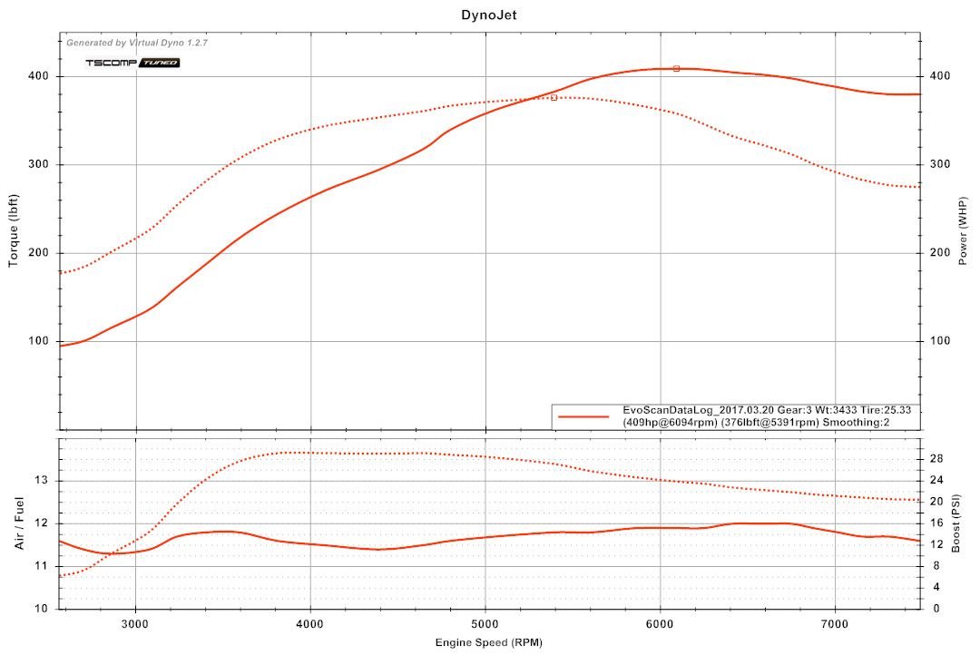

Pretty basic and reliable stock turbo results for those interested in stock turbo results.
We kept torque around 380wtq for maximum reliability. I could have easily went much higher with torque, but tuning isn't just all about extracting maximum power when dealing with stock internals.
Boost peaked around 29psi.
Fuel is E70
Loc: WI / 52F
Mods:
Stock Block evo 8
Stock IX ported turbo
Ported exhaust manifold
HKS 272
FIC 1120CC
AMS FMIC / Muse piping / Tial Q bov
Grimmspeed 3 port
STM 3" SD intake / filter
Map o2 dump / 3" exhaust
Tephra v7 SD /w ecuboost
