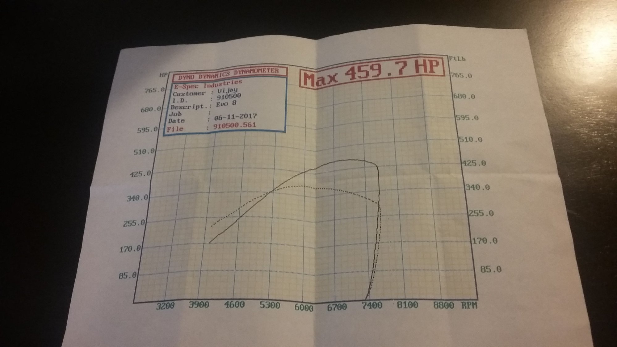

Hey guys,
Just sharing my dyno results and tune with you to get some insights as to what u think . I have a fully built 2.4 with fp green hta tuned by Espec . I was hoping to make more power since I walked with my E85 but my tuner wanted to go easy on my build to see how the car will react to the tune . So basically it's a mild and conservative tune .this is my dyno sheet below . So even though as I said I didn't make the power I wanted the car still feel amazing .

This is an insanely conservative tune. Your torque should be hitting way sooner even on pump gas.

Like said torque is low but sounds like tuner has you on a "break-in" tune? HP looks about right for being on a Dyno Dynamics. After some miles expect torque to be 480 +.

E85 will help this thing come alive. My buddies 2.3L, FP Green, S2, E85 setup did 530/520. Car was awesome
I used to drive one too!!! Great fun. So he did this on a DD dyno (which read more like a Mustang)?? ....I suspect those are Dyno jet numbers.
Yeah he told me he tuned it as if was a stock car seeing just came out of the build so guess he didn't wanna beat up on it right away. What do u mean I'll see 480+ tq after a few miles ?

Anyone have an idea what my numbers would read like on a dyno jet ??
I meant after your break in....usually 1000 miles. Then tuner can then crank up the boost.
The previous posting by e_Kobz friends car suggests what you can possibly make on a Dynojet.
Your results may vary. I made 417 whp and 480 wtq on a Mustang dyno with a old FP green turbo. ....was a blast

I plan to retune with more boost on e85 and o2 dump see what hapoens . It's been like 2 months now since my first tune so yeah car is due for a retune and step the boost up.

The pull looks to be started kinda late in the rev range. why not earlier?
yeah, somethings up if thats an hta green.
i will post my 3rd gear 91oct/e85 numbers in a bit.
im running a 2.4L, hta-grn w/R2 cams @ ~9.0:1 cr.

Tuner needs to start the pull at 3k or 2500. That thing should hit at 3500.

I was about to say torque kind of sucks needs to be way more to the left...not the # itself but the torque curbe looks horrible for a 2.4 but I see the pul was started late.
a green on a 2.4 should make pq tq around around 3800 to 4500 rpm

My old ride ..... about as to the left as you can get. MAP 2.4 L on E-85 and with a FP OG green (6 years ago) Mustang Dyno for reference:
https://www.evolutionm.net/forums/ev...-2-4l-e85.html
