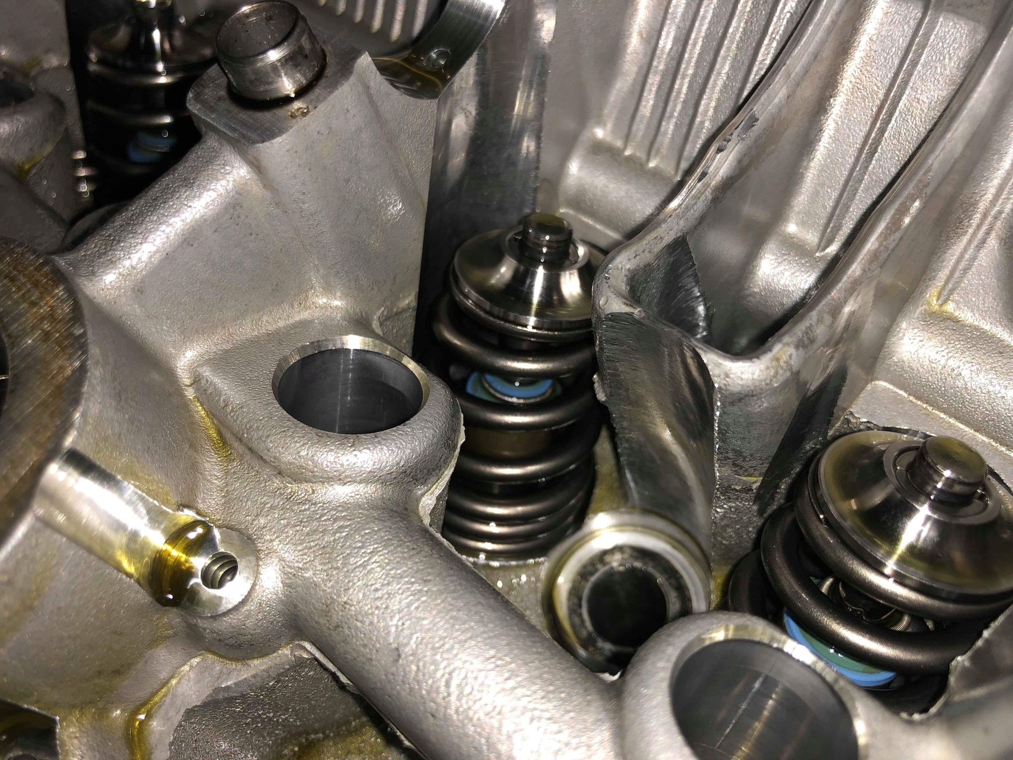

Kasey sent me this today. Not sure why, but he said the gsc heavy duty seals I had installed a while back were hitting the retainer so messed those up. That may explain the blue smoke I’ve been seeing occasionally.
Just waiting on head to get back. He said he hopes to have it on the dyno next week.

What valve springs and retainer are you using that's hitting the GSC valve stems?
Old Aug 30, 2018 | 09:20 AM
Bmurray's Avatar
Joined: Nov 2012
Posts: 644
Likes: 69
From: Burlington, NC
its the gsc beehive spring & titanium retainer combo
