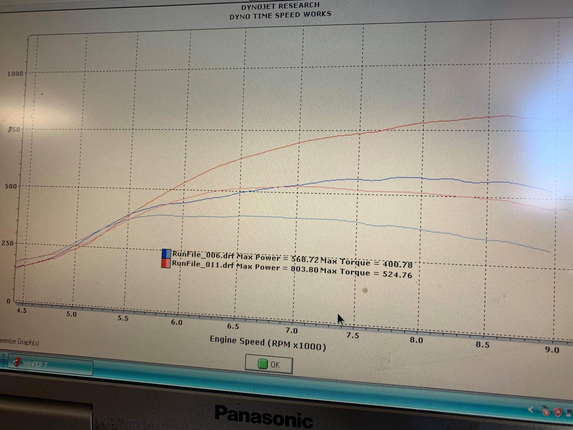

Well the car just made 803whp and 564 ft lbs at 39psi.
I wasn’t able to make it down but Kasey went ahead and buttoned it up.
Ordered a Sheepey catch can and also ordered a 3an turbo feed line going to see if that helps with the smoking.
When I get home on my computer I’ll upload a video
Shazzaam
Curious about the large spread in no.s from WHP to WTQ
Is that a normal spread on a high HP motor?

Shazzaam
i think turbo choice and displacement has a lot to do with that
Based on the relatively delicate nature of our Swiss Watch drivetrain, keeping the TQ to the lower side is likely a good thing

Awesome results! Are the lower #’s on 93 pump and if so at what boost? Thanks
Would love to have a ride in the beast
Yep exactly! Even though I’m sure 7-800wtq feels nuts
Lower numbers were for the low boost map. 27psi e85
thanks for the reply I was just curious to see if it was pump gas as I’m looking to go with a 6446 since I have a 2.3 engine and don’t have readily easy access to E85.

Torque is as such because it's a 2.0L. I built a 2.2 6466 car that made 620wtq, and 2.4LR 6466 car that made 665wtq. ER stopped at 665wtq on the hist because that's the most they have made on a 100mm crank...lol. Car made 800whp with 35psi out the top.
The drivetrain holds up fine. It's the motor that will live a shorter and shorter life as you go faster. The ER drag car that went 7's made 880wtq, and it runs a stock ACD transfercase...
