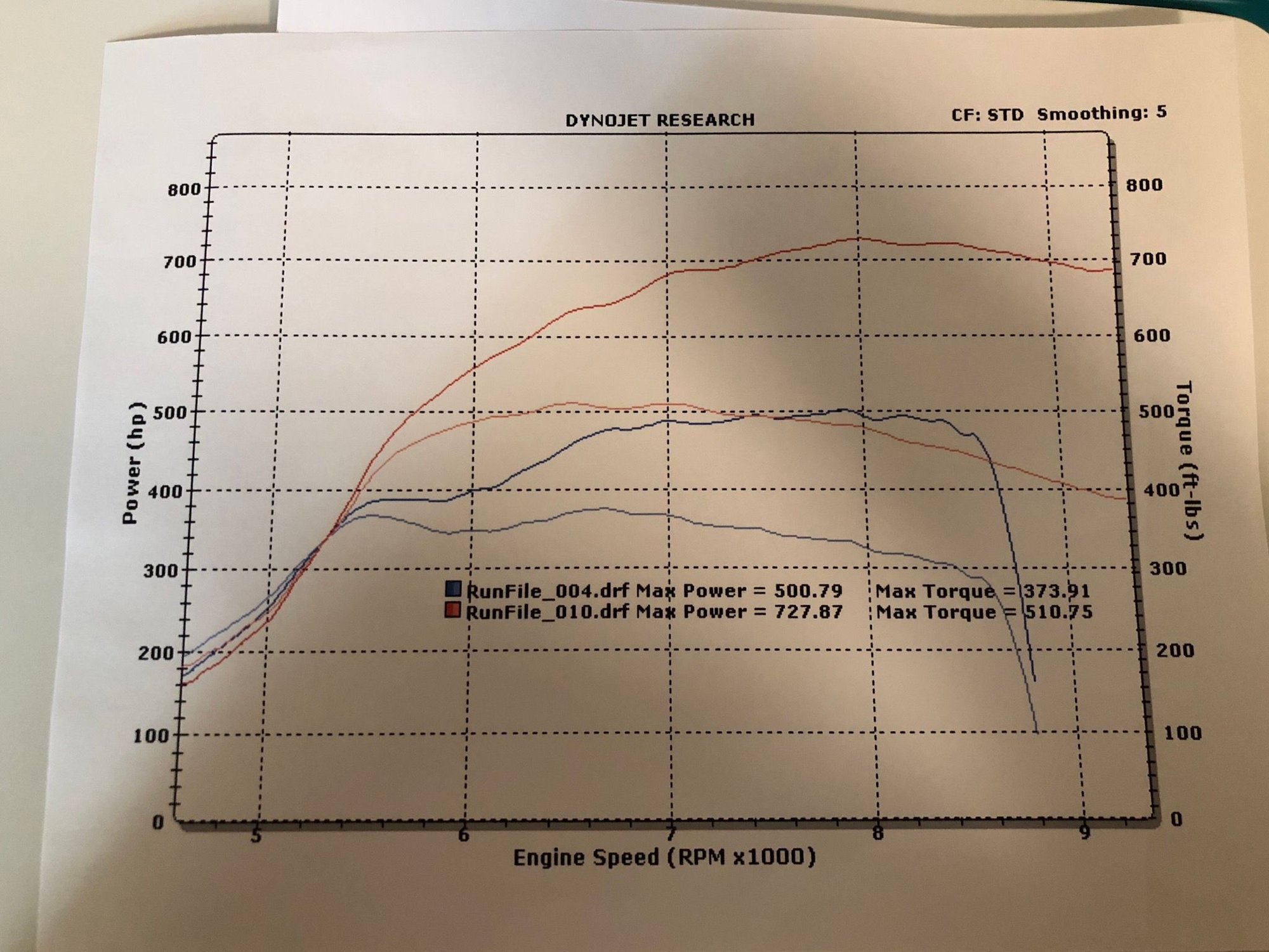

Pretty satisfied with what the results were today. Left it around 38psi.
727whp / 510ft-lbs
Car is still unported head, stock intake manifold, and stock throttle body. My tuner def recommended Cnc porting the head and he also recommended stepping up to s3 billet cams. He thinks I’d have hit 750 at this boost level with those additions.
The car pulls like a freight train though. Before leaving the shop, Kasey had me take him down the street to check how it drove and from a 40 roll it spun all 4 for a split second in 2nd gear.
Got home and my odyssey pc680 battery took a crap. So can’t even drive it until new one comes in...
anyways, hoping this turns out to be a good investment! I’ll be happy as long as I get a 9 sec pass

Needs a manifold, head and S3's. Then it'll carry power past 9k. A manifold and just S3's (or Kelford 280's) would probably pick up 50hp with the stock head.

Congrats man. Looks like he got it dialed in quickly on the stock ecu.

Wow, that's a lot of power at only 38 psi boost! What was your IDC at? 60-70%?

The Precision Gen2 6466 does work. I've seen them make 800whp on more complete builds (Magnus IM, ported head, S3 cams, etc) at about the same boost (37-38psi).
727whp / 510ft-lbs
