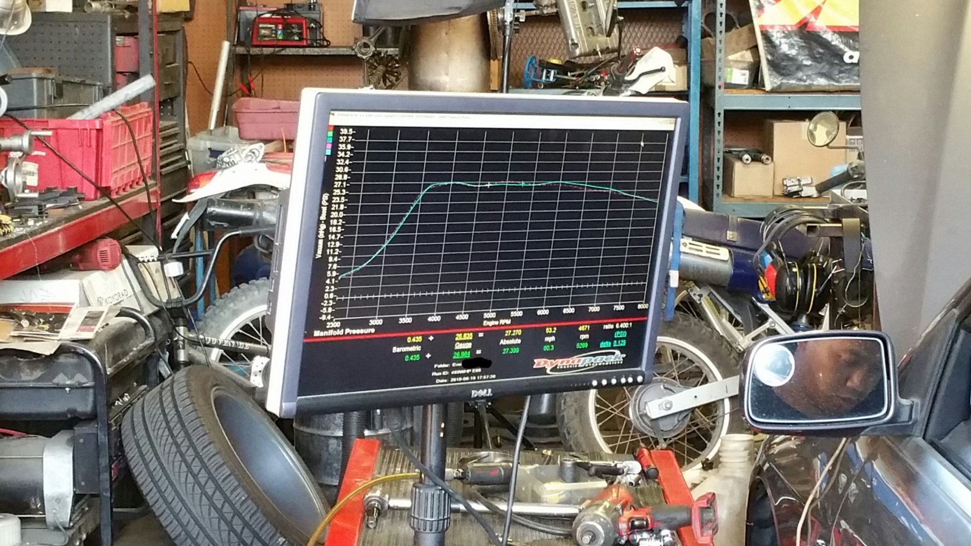

Here's my boost on 71hta and E85. A few weeks ago, I worked past midnight and came home around 1am. Temps were really cool and getting on freeway, boost spiked to 33 psi. I was shocked to see that high of a boost at 4000-4500 rpms.
so 71hta holds 25 psi at 7,000 and tapers to 21 psi at 8,000 rpm. Stock IX will be worse and stock 9.8T will be even worse.

Originally Posted by 2006evoixer
here's my boost on 71hta and e85. A few weeks ago, i worked past midnight and came home around 1am. Temps were really cool and getting on freeway, boost spiked to 33 psi. I was shocked to see that high of a boost at 4000-4500 rpms.
mbc?
Edit: NM read your sig 3-port. Is WG correction disabled?
