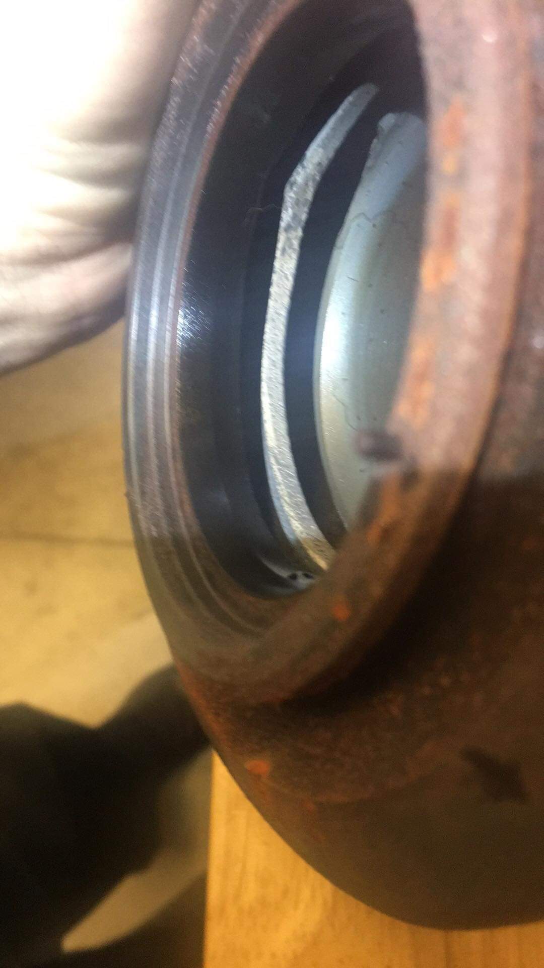

If you are going to run turbos from manufacturer, FP Green is best on your list. I will be upgrading a Tomei with an aggressive 20G in a few weeks. I like how beefy the Tomei hotside volute divider is.
Old May 2, 2019 | 08:17 PM
2006EvoIXer's Avatar
Joined: Jul 2012
Posts: 3,294
Likes: 197
From: California
Tomei from factory uses a cast 20G, so it's not any better than FP 71hta. But an aggressive billet 20G will give FP Green a run for the money.
For reference, left is oem IX and right is cast 20G..
