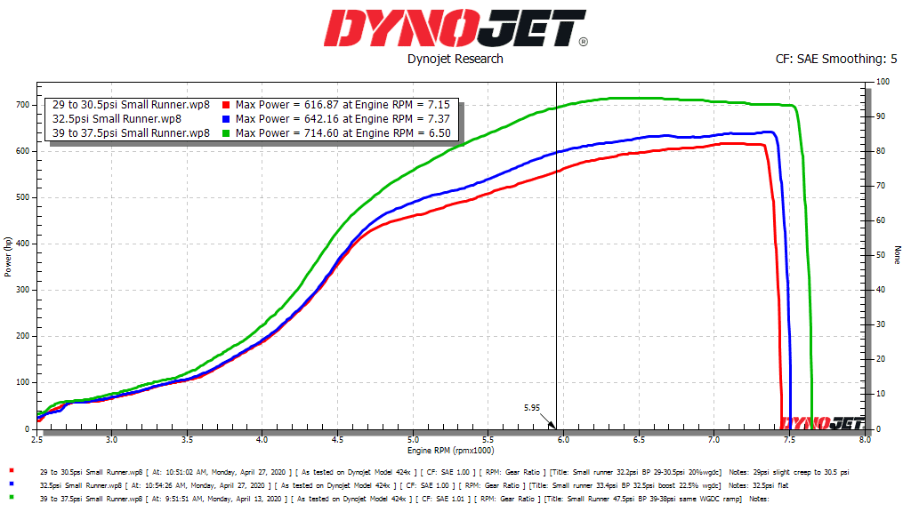

MF Small runner manifold overlaid at each boost level:
These are the pulls for small runner manifold only.
Red 29 to 30.5psi, blue 32.5psi, green 39 to 37.5psi
The green higher boost pull had the more aggressive boost ramp rate (the same as all of the large runner boost ramp rates) and the lower boost pulls had the softer boost ramp rate and illustrates how differently some of the small runner pulls came into boost. There may have been some other additional factors to possibly increase spool up in this particular 38psi run, such as the exhaust manifold possibly being at a higher initial temperature which could help spool, but either way this was the result when the boost ramp rate was the only known variable that changed.
The pulls all track nicely as boost increases, with the high boost pull leveling off sooner- likely starting to be dictated by the 62mm turbo getting closer to its limit.
