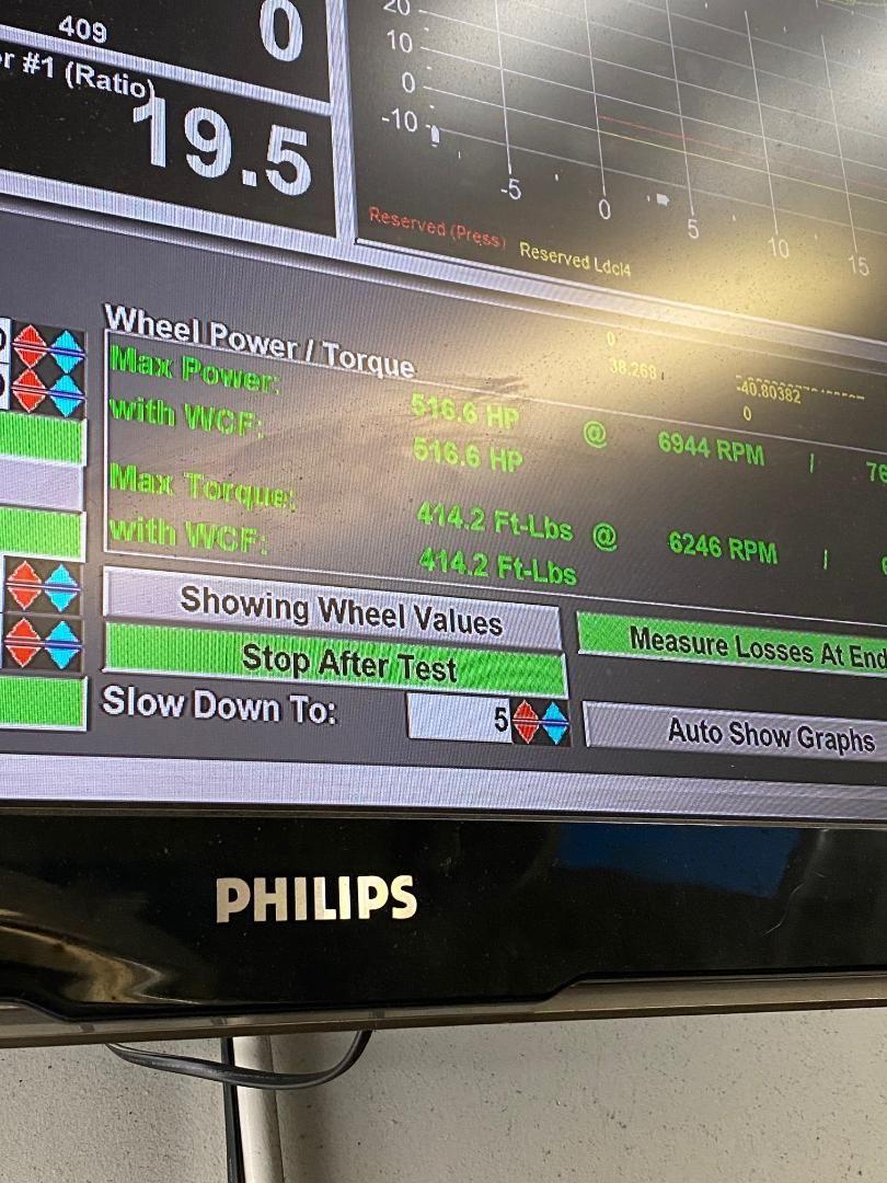

Hey guys, figured I'd post my results from getting tuned last weekend. I bought the car back in November with 76k on it, and decided to see what I can do with the stock block before I plan to build it next winter. The car was tuned at RRT and it made 516whp/414wtq. Raif did not want to push it any further and I was happy with where it sat. Mod list/Pics below:

Nice numbers . How's the lag on the FP black on the stock block? Would be nice to see the dyno graph as to when you see full boost.

Completely forgot to snag a photo of the graph, I was seeing full boost(33psi) right around 4000-4100. It didn't feel that laggy to me, but I'm coming from a 6466 set up on a subaru its been awhile since I've been on a stocked sized turbo so I don't have much to compare it to.
