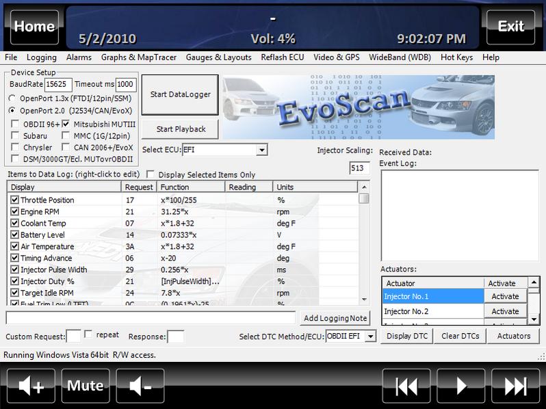

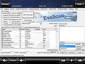

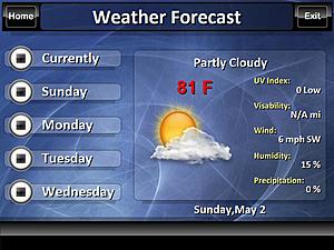

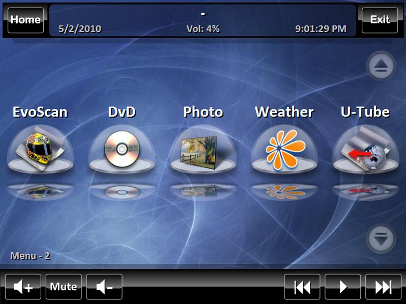

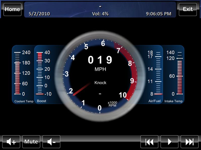

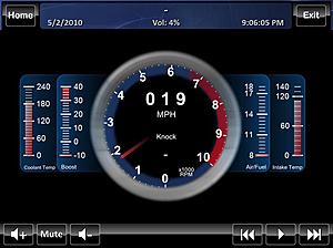

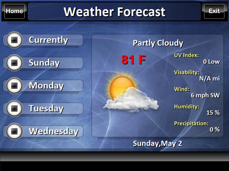

Got it working!!!
Taking Acree's and l2r99gst's advice, I gritted my teeth and started learning RideRunner scripting and skinning and got to a VERY favorable point tonight (only took 2 days to get here...so RideRunner is fairly easy to customize). I managed to not only find a decent skin to start with that was stable, but the person who coded it commented the code well so I was able to get in and start making it fit my specific setup. I got EvoScan fully embeded now as you can see by some of the nice looking screenshots below:

Very nice. That definitely looks like a step in the right direction. Any headway on the problems coming out of hibernate?

Yea, that was all Centrafuse, as soon as I dumped Centrafuse and went to RideRunner all resume issues are gone. I did test going to standby/resume today too. Coming back up from standby is stupid fast, I'll probably switch to that setup this week. I'm tweeking it up, then will build an image out for that box based on tinyxp with all the configuration settings I have been developing over the past month. I may build another one of these for a local guy (perhaps two), so having a ghost image will be awesome, just load the image on their computer and go.
