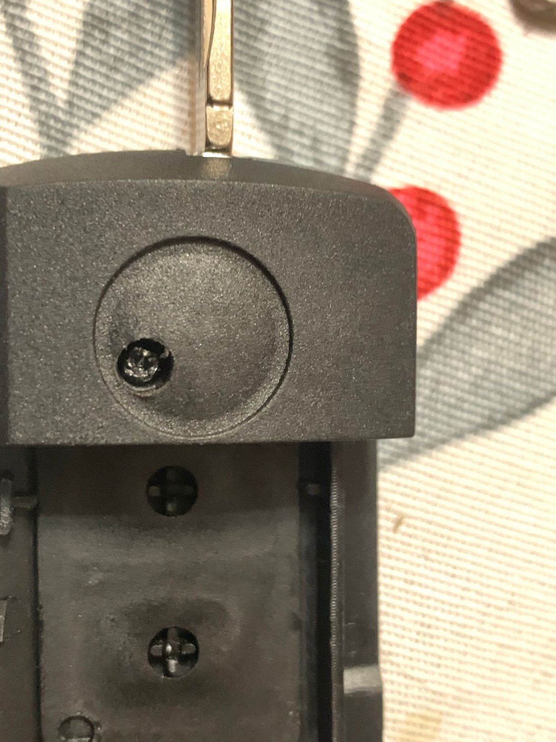

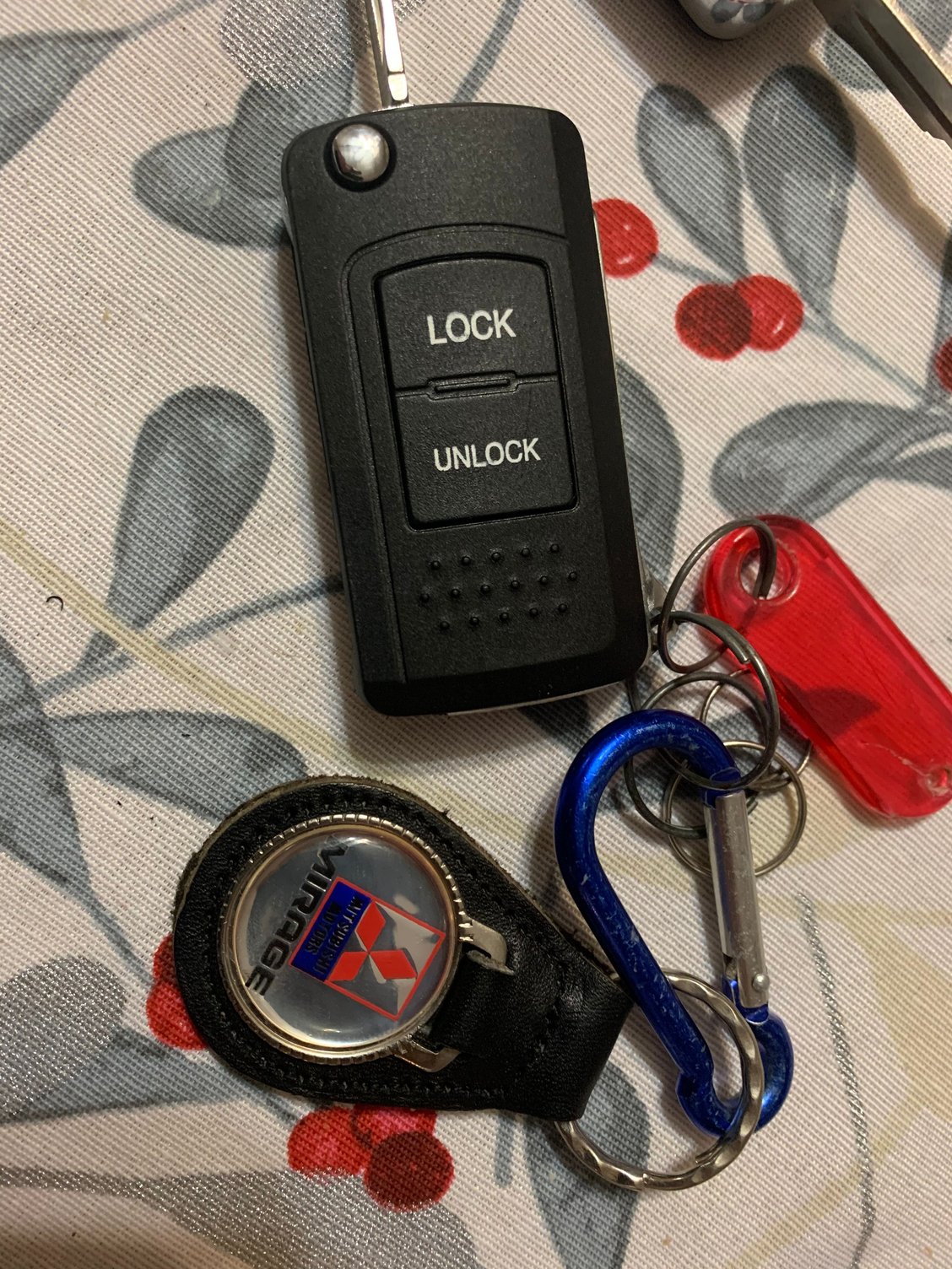

All done. I messed the 1st one up pretty good. You have to remove the rubber thingy from the electronic key fob BEFORE installing it or it’ll never fit. There was a plastic stem that holds the fob in place I snapped off and then stripped the screw holding it down. The second key took 5 mins including splitting the original key and getting the transponder out.
Starting the Evo is a little finicky. The guy who cut my key was older (been in business since 61) and cut it a littler high so after putting the key in to start I have to pull it out a micron or 2 to get it to start.
This key shop I found was classic. The owner had these old key chains from the 80’s. Want a brand new key chain for a Mercury Topaz or a Buick Electra? He’s got it. He had this ancient Mitsubishi Mirage key chain for $3.50 I figured why not? Close enough. $4 to cut both blades and cut me an emergency spare to get into the car.
Great thread thank you. It made this exercise easy.
