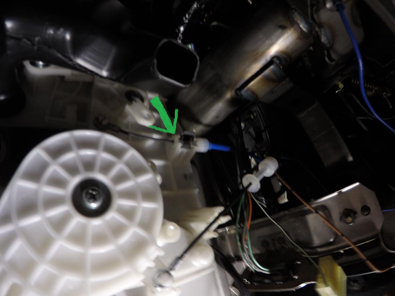

alright lighting for the climate control was fixed. turned out to be bad bulbs. As for the heater switch not working I got a new cable and gears but the problem is is that I can't find the clip that holds down the cable right before it attaches to the gears. What I mean is that the previous owner lost it and didn't tell me. I can't find where to by it. Or a part number for it. I'll include a pic of the clip on the other cable with a green a arrow pointing to it.

Every Evo I have owned except my current 03 has had a heater/cooling flap cable issue.
They don't seem to last long after replacing either.
