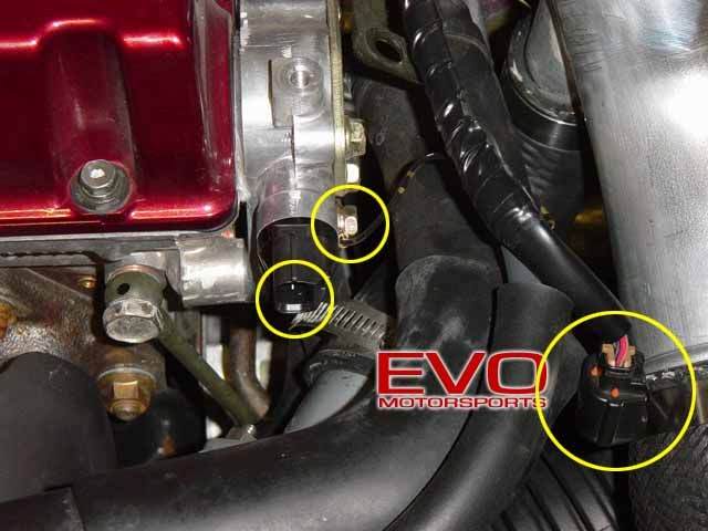

I have a question regarding the ground wire that is bolted to the head next to the cam positioning sensor.
Is this ground wire fed straight from the negative battery terminal to the block or does it come from a pin on the ecu or any other delicate sources?
The wire in question is in the top middle yellow circle.
Picture taken from evomoto:
I fear I may have sparked this wire against the positive battery terminal while removing the battery. Thanks in advance guys.

I checked for continuity to the chassis and it is directly connected. My guess is that you can actually put that wire anywhere on the bare frame or engine and it would still behave the same. I fired up the car and didn't notice any difference either. For some reason I thought that it was specifically fed to a resistor pull down source at the ecu or maybe the negative signal lead to the cam position sensor haha. Guess I was wrong.

I traced it all the way back about 2 1/2 feet towards the passenger side and it bundled to other multiple grounds. replaced it all and no problems so far.

That's a relief! So it's just part of ground distribution.
