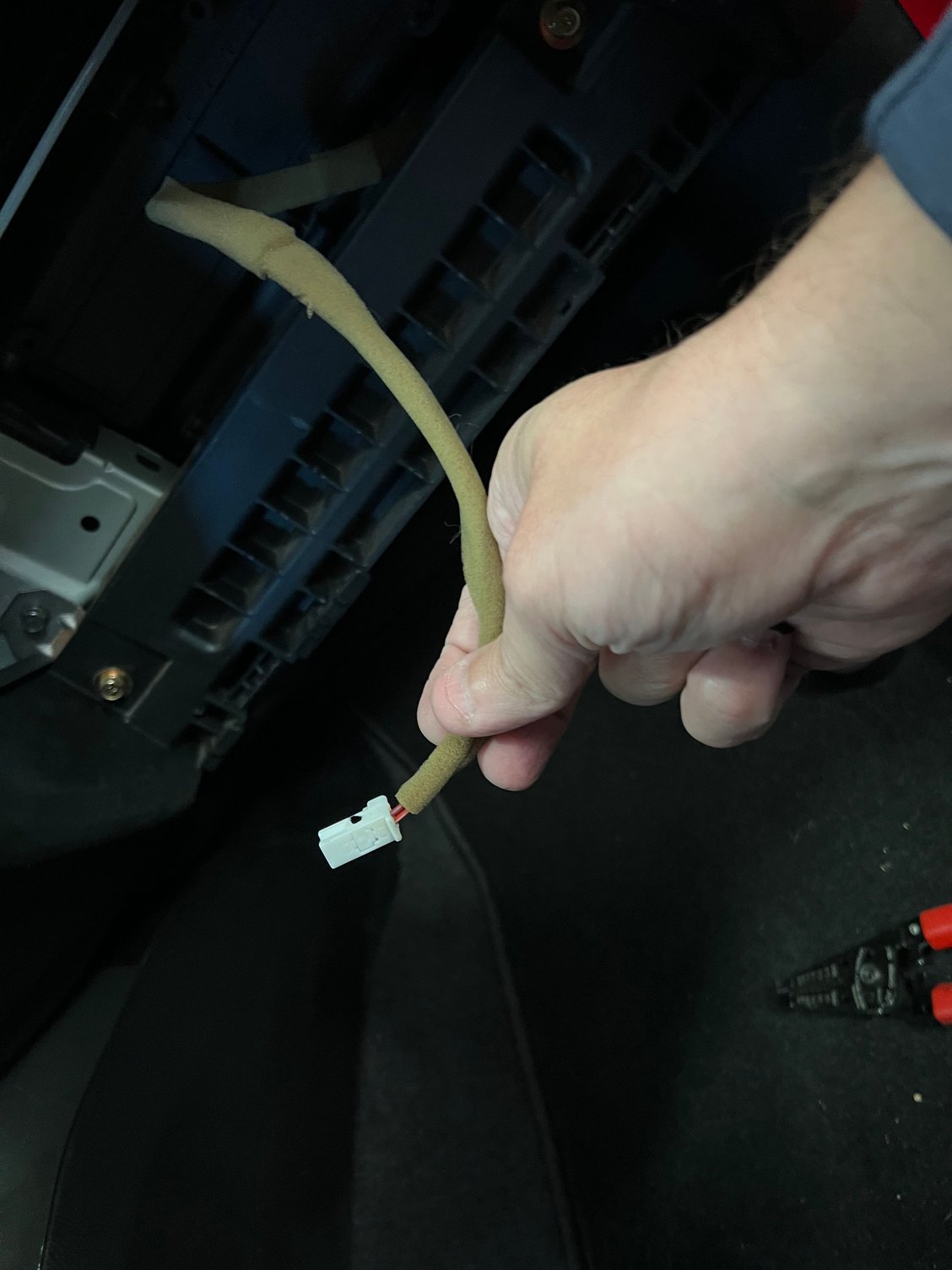

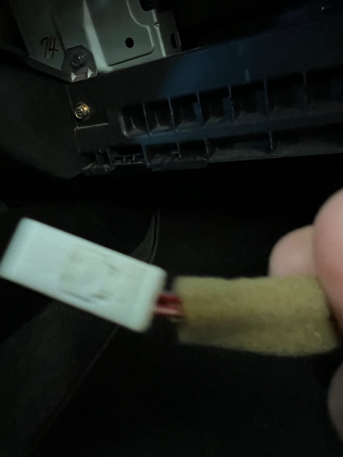

I’m currently working on a 2003 Evo that I am confused about. This factory door wire under the dash used to connect to something, but I am having a hard time figuring out what went to. Any ideas

what are the wire colors?
Not too many 2 pin connectors in that area, so I'm going to guess HVAC blower motor.
It’s not that either, thank goodness. It’s not the overhead light or the map lights, either. Nor is it the intercooler sprayer.
Thanks everyone for trying to help. Wire colors are red with a white stripe and red with a blue stripe.

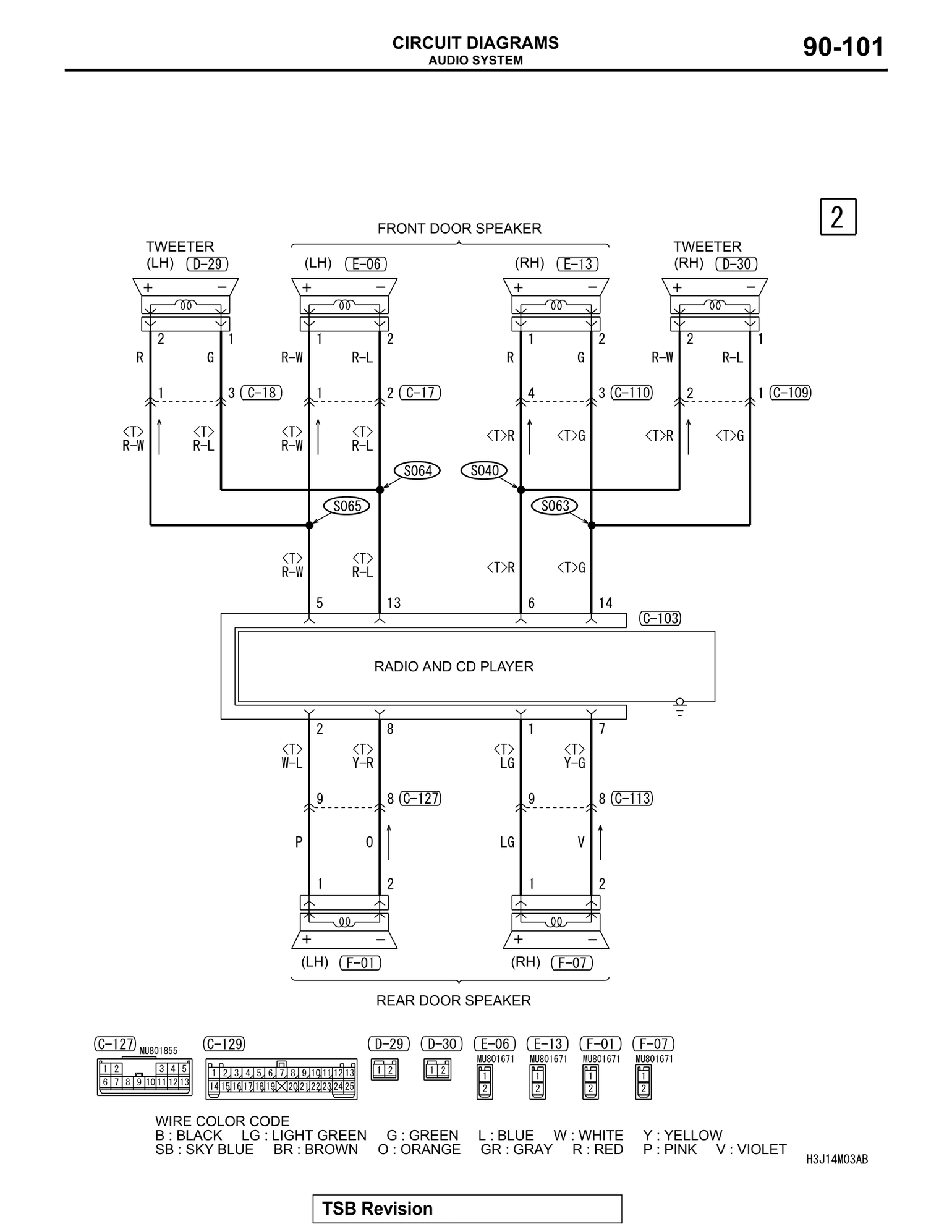

Stereo - RH Tweeter - Connector #C109

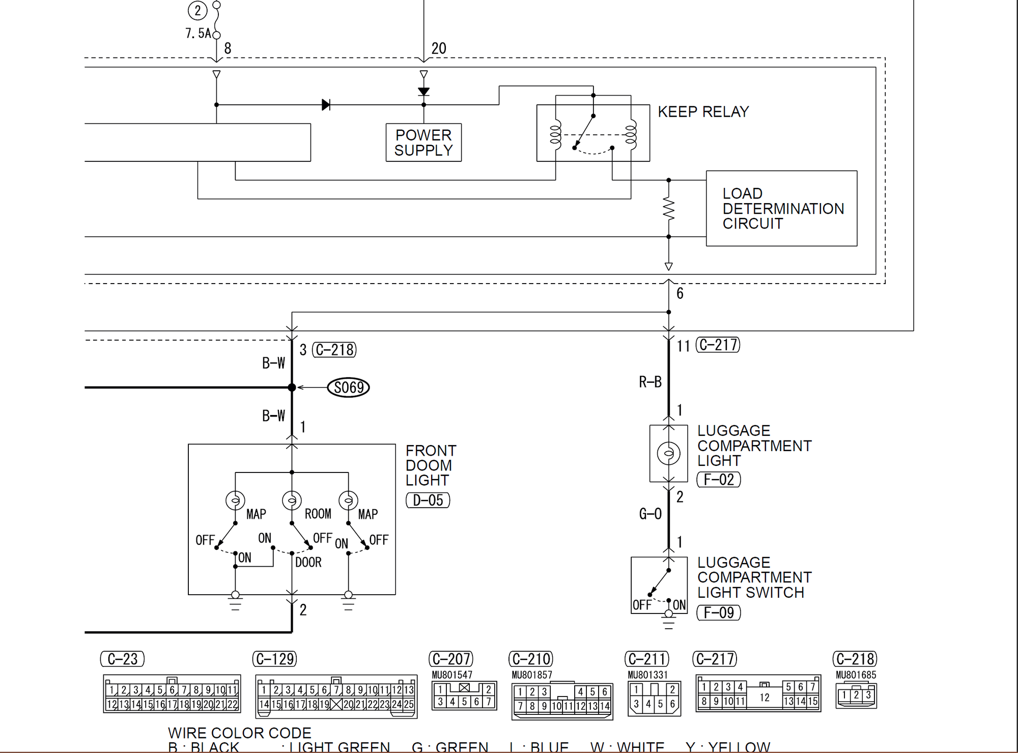

Funny side bit, while skimming through the circuit diagram I noticed a typo? where Mitsubishi calls the dome light the "Doom Light"

Your welcome
No typo. They meant that LOL
Just checked my 9 manual. Corrected and the offender is no longer w/us
