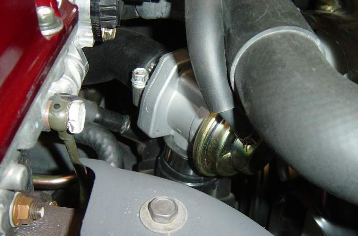

You installed your BOV backwards. That's what's causing the fluttering. Flip it around.
Old Oct 20, 2004 | 08:06 PM
marksae's Avatar
Posts: 2,995
From: SF, CA
It's supposed to be oriented like this:

lol what bov is that? i'm pretty sure i reinstalled the stock one back to the way I took it out..but I guess I can flip it again...I know that I had installed my forge backwards then fixed it and still got a little flutter..but i think the stock on is installed right i'll try switching it..but I dont think thats the problem..we'll see i guess :-P

It's the JDM MR BOV.
Read this thread. This guy had his BOV installed backwards and had the same fluttering issues as you.
