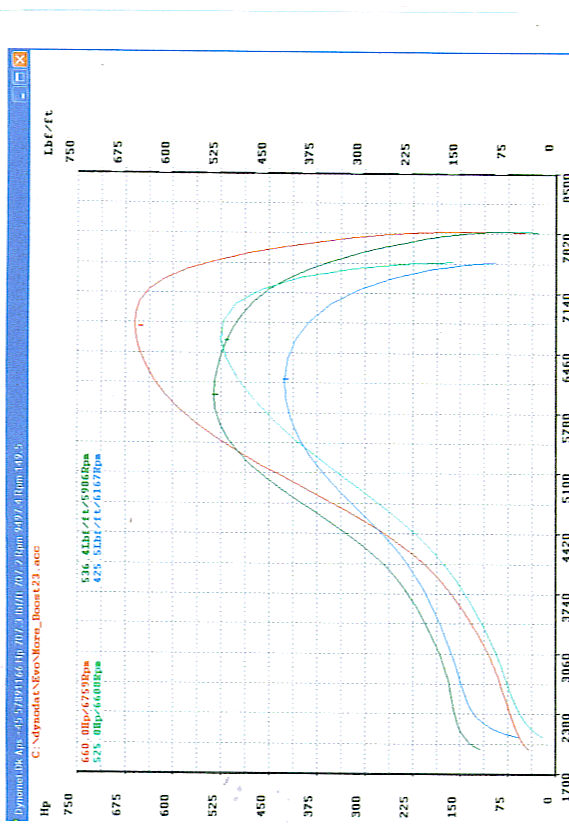

I've done all of the tuning that I can to my EVO. The HKS 3240 fit maxes out at 29psi at altitude (6000 ft absl). At sea level this turbo is good for 35 psi. Up here it starts to move out of its efficiency range after 29 psi. Also, large turbos take much longer to spool at altitude. I wanted to try two different types of dynos to see how they compared. This run was done on a AWD dynojet. This is wheel HP.

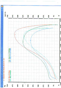

This is done at Kleemann in Colorado Springs. They use a two wheel dyno that estimates crank horsepower.
