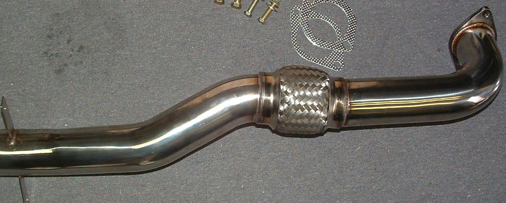

We run braided stainless flex sections in all the downpipes we currently build for the DSM,EVO,SRT-4 and WRX. I don't feel they are a restriction at all. I do have a lot more piece of mind that the downpipe with a true flex section will last longer without cracking at the welds. Here is a pic of our set up.

A pic of the inside of one of your un-assembled flex sections would be more telling...

I posted a pic above. The flex we use is double braided for strength. I respect your opinion Zeus, but I just think the real flex section is a more reliable solution. I have seen many well known companies that get rid of the factory dounut and they do use a flex section either. I think this is just asking for trouble.
