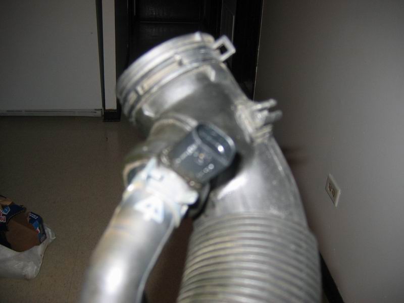

I bought the car with the MBC on it already so I dont know how the stock one looks like. I hope it is the one that I've shown below. Did you guys remove the boost solenoid sensor or not when you put in the MBC? If not how did you leave it on there. Without the sensor the CEL comes on.
Thanks.

Show a better picture I could help you..... Talal

not sure what u mean but the picture shown was part of the stock MAS pipe

I don't even know what you have pictures of. What you posted looks to be some type of device in the BOV return hole...a stock EVO does not come with that. However it does have a BCS and that is mounted to the frame rail under the area of your intake. It has two hoses coming from it and a electric plug goes to it.
When a MBC is installed the BCS is capped off and not used. Or at least this is how I would do it.
