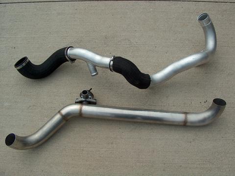

Well, the basic thing it does is widen and straighten the air path. Theoretically, this helps the turbos spool faster, so quicker throttle response. The Buschur site says their Upper IC pipe "eliminates 6 bends and 16" of length thereby reducing the flow restriction (less length, less bends, less restrictive flow). "

you can see the difference:
