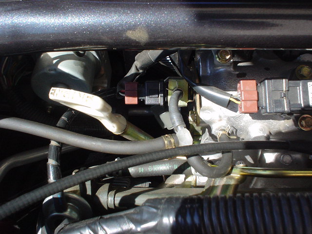

i just installed my boost guage with the help of the write up in the intall forum, my problem is that the guage shows that i am only boosting 14psi tapering to 11psi, what could be the problem??? i checked for leaks and did not find any. any help would be appreciated. ( i bought the car used and the person that sold it back to the dealer had it modded and then changed it back to stock, so now i dont know where to start looking to trouble shoot.

Does the car have a MBC on it? If so it may be tuned down for whatever reason the previous owner had. I'd also try another boost guage to make sure it's not broken. Also where are you "T" into to read the boost?

it does not have a boost controller atached to it, i also teed off the fpr line in the pic below

Make sure you cut the right hoses to tap into. I used one near the intake manifold and "t" connected from there. Also make sure the ends are on there tight. Might need to clamp them securely or zip tie them, which is what i did. If it does have an MBC then you'll need to check that.

your tapping into the fuel presure solinoid. You should move the tap to the BOV line.

I tapped into the same line. my boost gauge is on turbo timer though (DCII DTT Blitz) when i drive,@ WOT, it boosts heavy- 18-21 psi, then tapers down after about 5500 rpm's. to about 14/15 psi( sorry, it's hard to convert KP to psi while driving.
please help
A lot of us have had no problems using that location. That location will definitely give you a reading straight out of the intake manifold.

^^ thats wat i thought, i havent heard of anybody having problems from there, when i had a turbo civic thats where i tapped and it worked perfectly. thats why i am wondering if something was wrong with the car or something.

thats the line mitsu uses. heres how they tapped the gauge cluster

thats how mine looks
