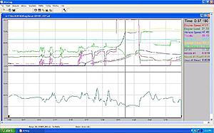

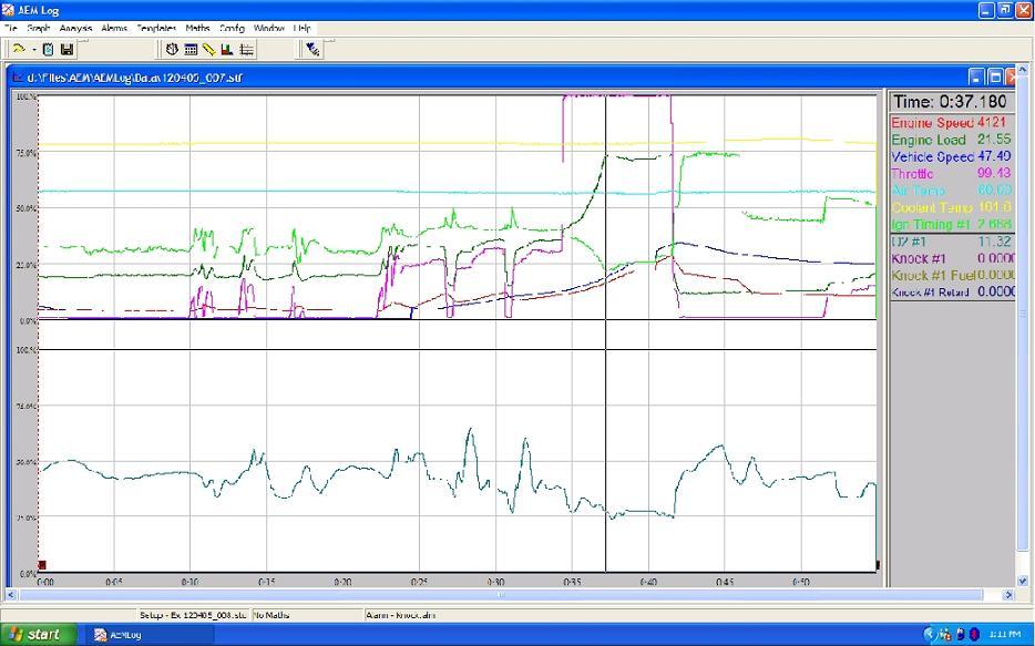

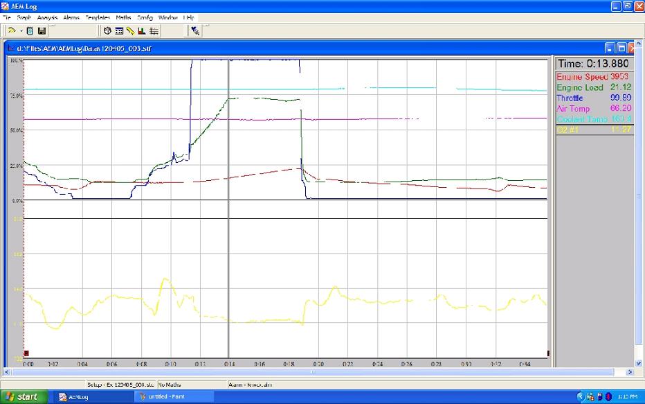

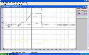

Here are some datalogs for you. One in 3rd and one in 4th. Hope it helps give you a general idea. Looks like I was right on what I though.
Attached Thumbnails Anyone with a GT3076R-3rdgearpull.jpg   Anyone with a GT3076R-4thgearpull.jpg

Thanks for the logs. That's about what I am getting with mine. I might be a little slower but I think my wastegate is opening a little early. What size spring do you have in your wastegate.
