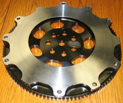

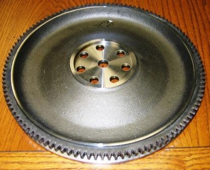

Well since you asked... Here are some photos of stock and ours. I took some quick measurements again for reference. The stock one weighs about 14.2 lbs and is about .35" thick behind the clutch disc surface (the area that absorbs the heat and warps).
Overall weight is not what is most important. It's more important to know where to leave material and where to take it away. Our Streetlite is over 40% thicker behind the disc area and weighs about 13.1 lbs because we took material away at the outer perimeter (for reduced inertia) and added behind the disc. Our Prolite is still over 15% thicker behind the disc but weighs only about 10 lbs.
Tell me what you think.

That is one very nice flywheel! How much would it cost?
How much do you have?? Just kidding. I don't know yet, because we are going through pricing on all our parts for our new catalog next week. But you know how we are... we will make sure the $$$ makes sense.
